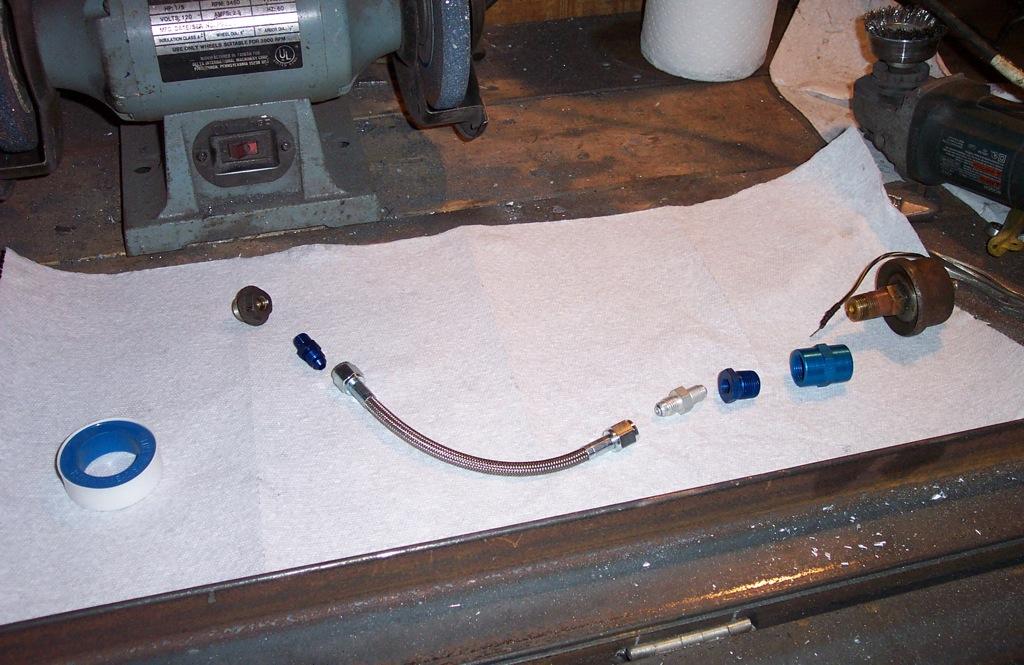

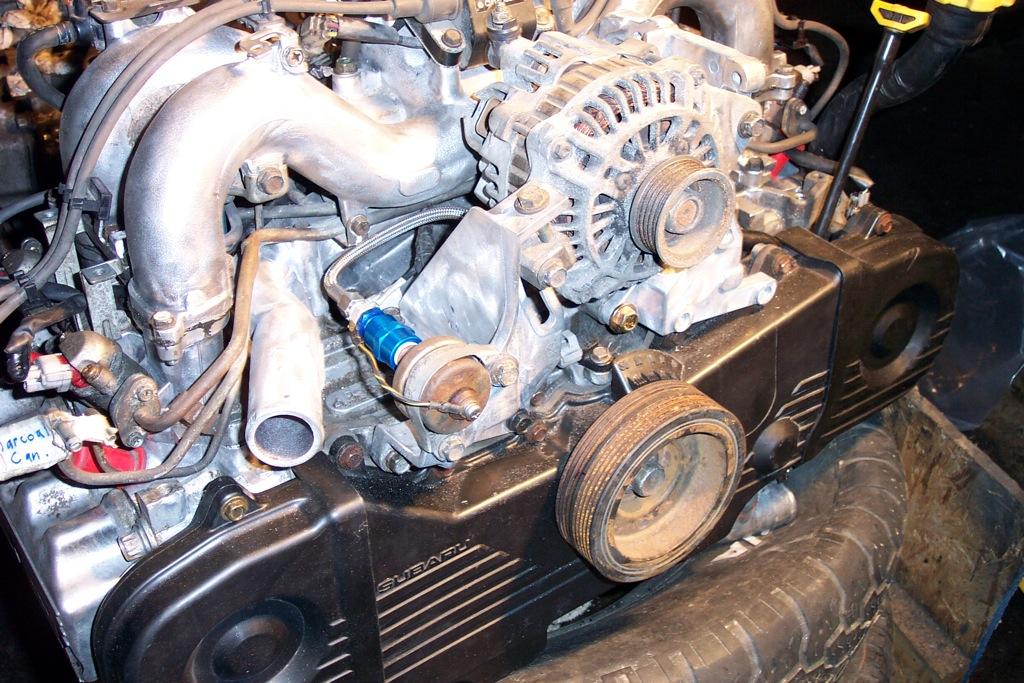

I did it using this crazy gaggle of adapters. There's probably a better way, but this actually worked great with a little teflon tape on the connections for a better seal. Has held up for many years.

You can use a bunch of adapters or get a cheap oil pressure gauge.
The metal fitting in the block is 1/8 BSPT. with a little bit of teflon tape and a bit of force 1/8 NPT will thread/crossthread in there enough to seal.

Does anyone know if the bracket holding the EA81 oil pressure sending unit (attached to the blue anodized adapter) to the alternator bracket in the photo below is a factory part or one that HatchMonster88 made himself?  I blasted past an image of something that looked VERY similar in an unrelated internet search earlier today and can't place it.
