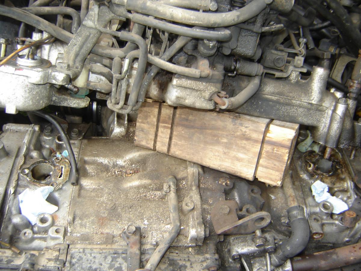

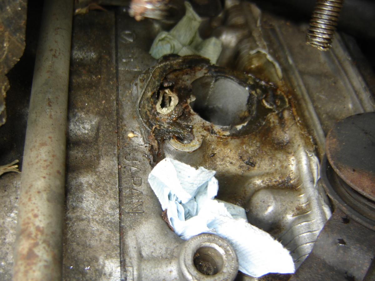

Yep, Here's how NOT to do intake gaskets -I think the goo is all that's left. With any luck I'll be back running this afternoon.
I am betting this is the extent of it. Never had this issue in all my Suby years. Maybe I freaked out a little, but better safe...
Thanks to the Forum for all the help!!! :headbang:

Wow!  Impressively bad.
