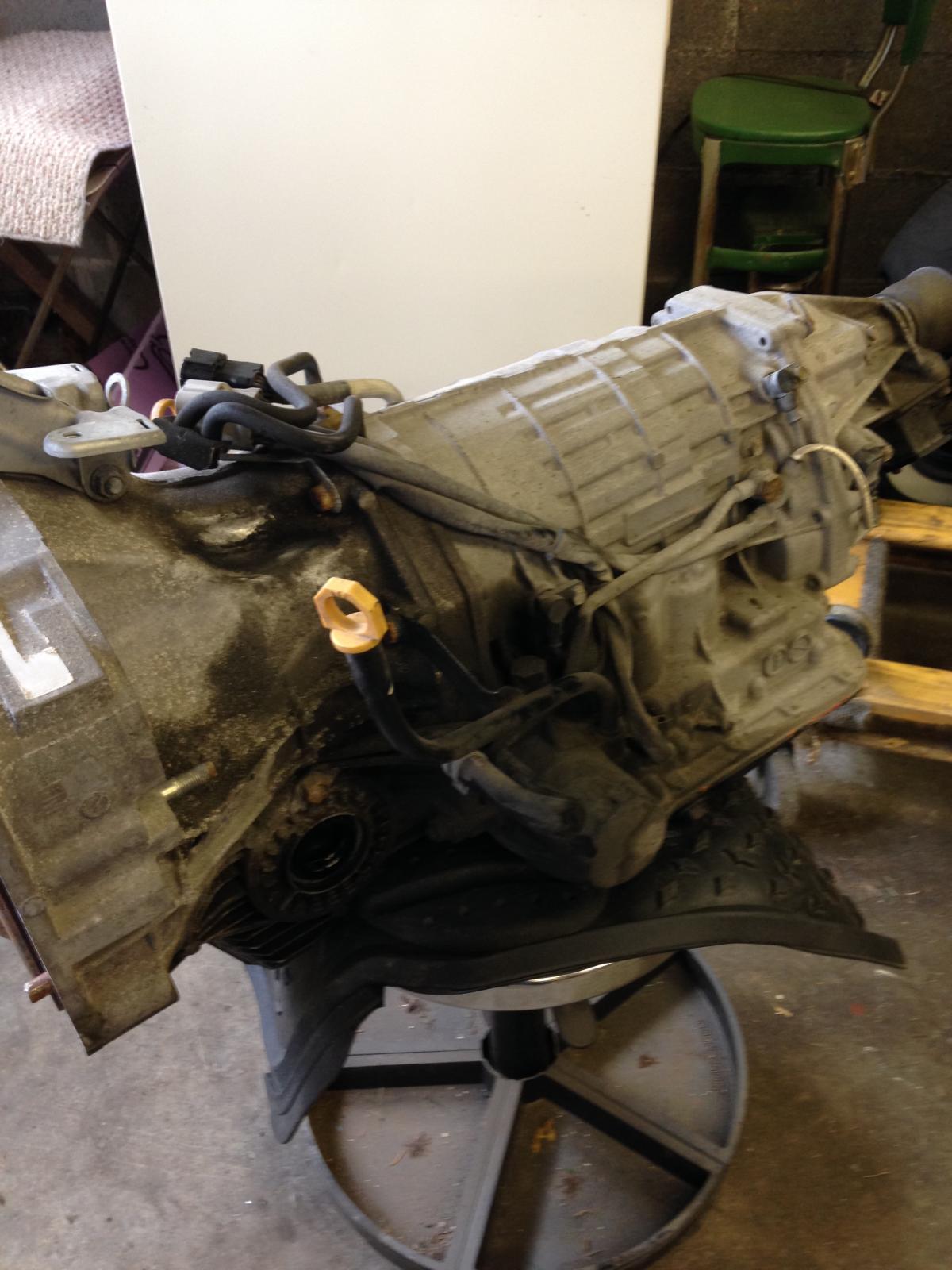

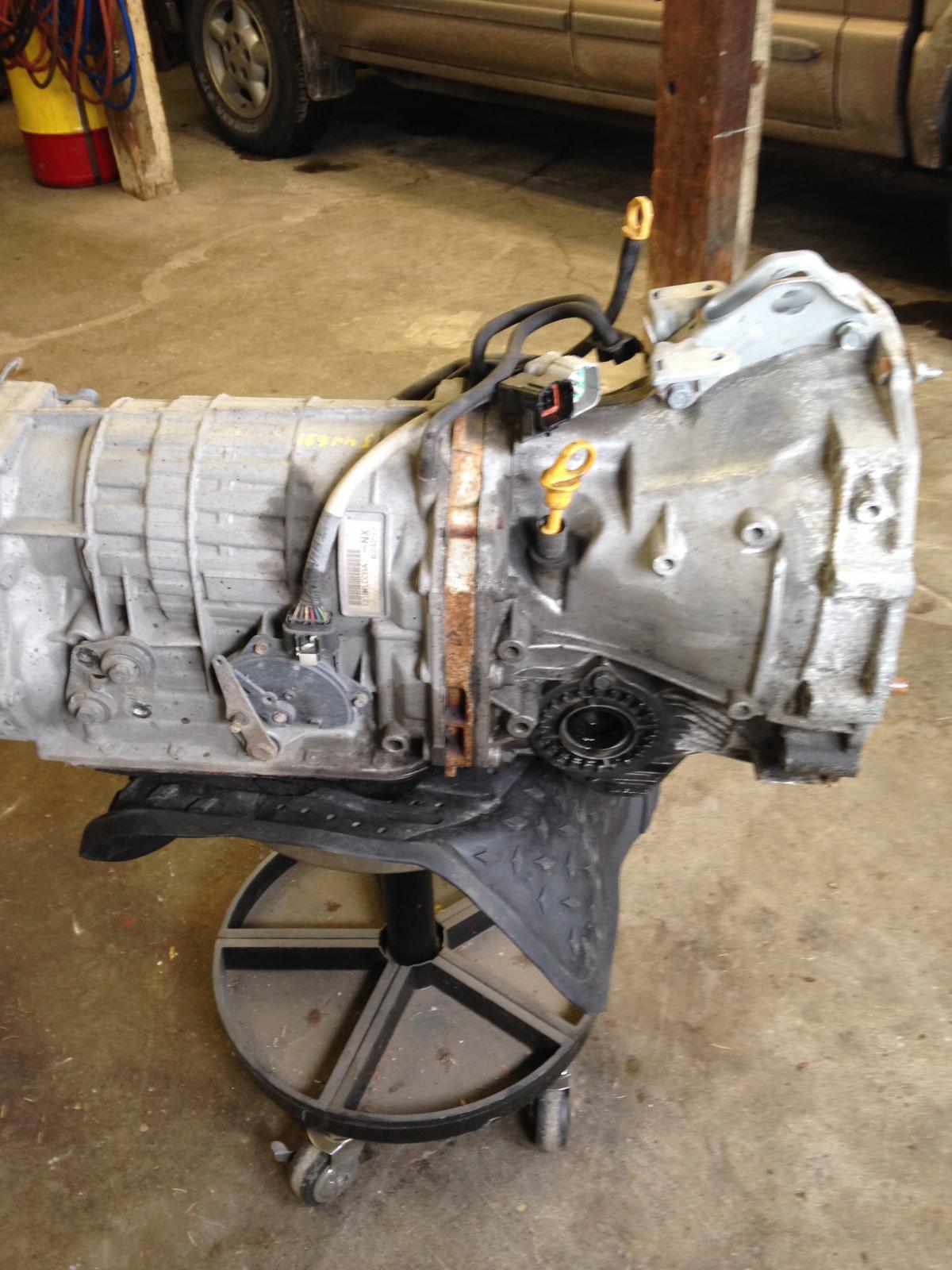

foxgap Posted February 1, 2015 Author Share Posted February 1, 2015 Ok, an update for you all. I had a new OEM axle installed in the car on Friday and the noise got WORSE. So it looks like the diff is definetly done in. I picked up a diff and trans from 98 2.2 car on Saturday and it is here in my garage. Thing is, is does not look like my 95 diff and trans but that is to be expected. I guess the speed sensor that is on my trans is now internal cause I do not see one on the 98. I gather this setup is a Plug and Play? No wireing to be done? Everything just plugs in and attaches? Please tell me yes cause this job has been a good headache that I would really like to get rid of. Is there anything that should be done to the trans before it is put in? Seals? Sensors? I remember reading about a selinoid in the tail housing of the trans? Thanks again everyone, Mark Quote Link to comment Share on other sites More sharing options...

Fairtax4me Posted February 1, 2015 Share Posted February 1, 2015 Uhh... If it doesn't look Ike yours its probably not the right one. Speed sensor is toward the front of the trans on the right side (passenger) near the dipstick for the front diff. Sometimes on a junkyard trans the speed sensors are broken off and you have to remove the broken portion from the hole in the case and put your old sensor in it. I'm also kind of wondering about the "diff and trans" part. The differential case housing is part of the trans and isn't normally removed. Can you post a pic of what you bought? Quote Link to comment Share on other sites More sharing options...

foxgap Posted February 1, 2015 Author Share Posted February 1, 2015 Ok , gonna try to send 2 pics.... Quote Link to comment Share on other sites More sharing options...
foxgap Posted February 1, 2015 Author Share Posted February 1, 2015 Quote Link to comment Share on other sites More sharing options...
