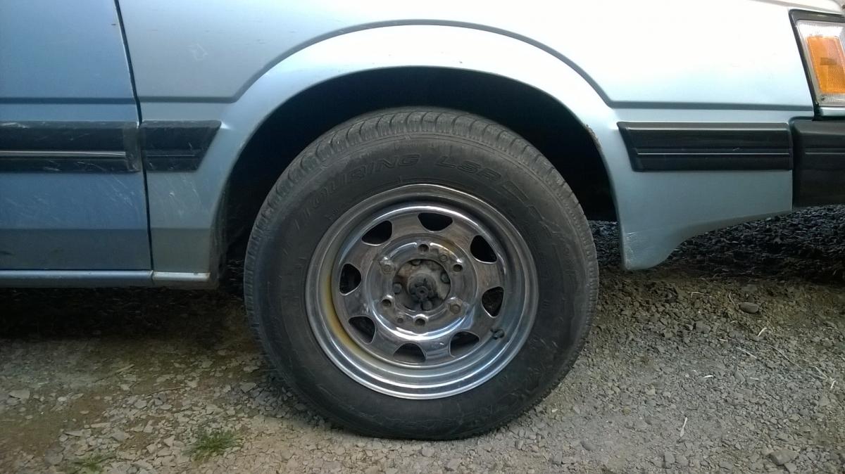

So the final decision was to drill the wheels. The hubs seemed risky and like more work. Here's how it went:
Step 1: Very particularly find drill points
Step 2: Drill tiny holes
Step 3: Gradually drill larger holes until 9/16th bit
Step 4: Drill an angle for the lug nut
Finished drilling:
Step 5: Grind an extra few millimeters into the center to fit over the hubs
FITS! I like the look.
aw yeah:
Edited by lostalfos

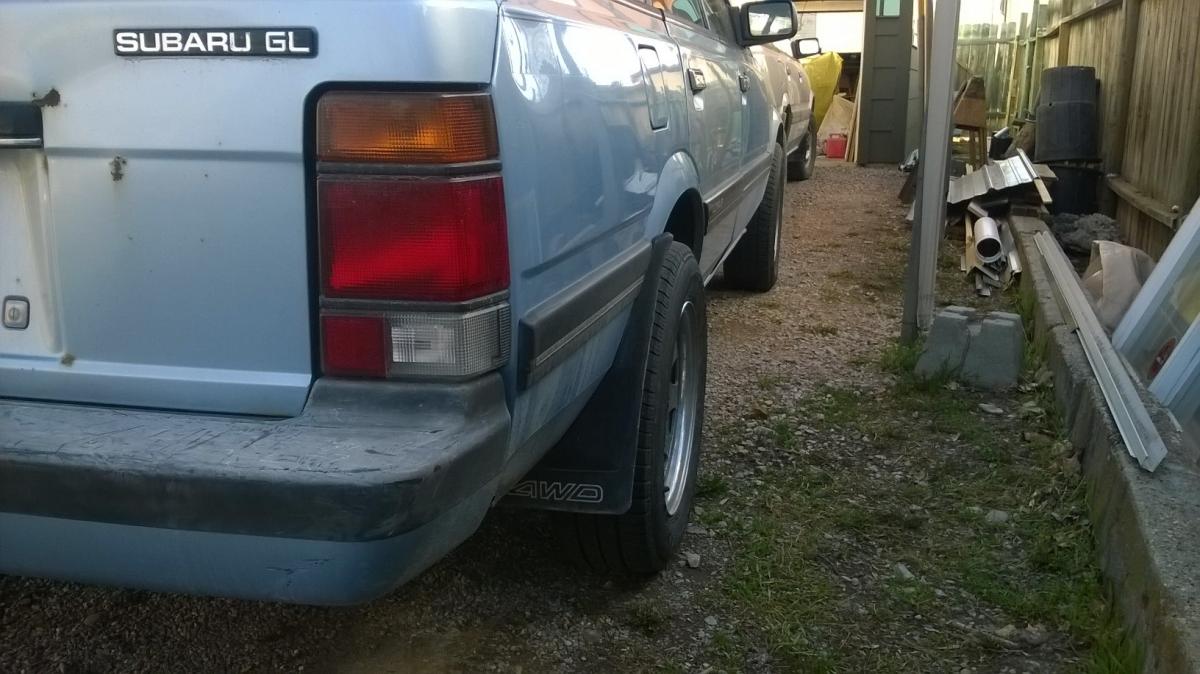

Funny, I saw your picture and thought that looks similar to a picture I took haha. I want to modify the bumper and take off that awful part that sticks up. Eventually, any more plans for yours?
Interesting, what is that part that sticks up all about? well, i just got the windows tinted and am planning on lifting it 2" in the future, getting some decent tires too. I thought about a black hood. Some brighter lights is going to be a necessity. unfortunately my headlights are suuuuuper dim atm. maybe corrosion issue or something from the previous own leaving is outside.
