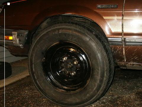

archemitis Posted September 23, 2004 Share Posted September 23, 2004 id have to trim more, and beat down some stuff a bit more, but that thing would fit without a lift! its a toyota wheel redrilled to fit, with alot less backspacing than the pugs i run now with 25.5s. i swear its all about how much japanese steel you want to cut! Quote Link to comment Share on other sites More sharing options...
Rooinater Posted September 24, 2004 Share Posted September 24, 2004 yeah you could make them.... but why?.. if your going to spend the money on tires why not shell the money out for a lift. you'll get better suspension movement without rubbing, better offroad clearance and ability. why does everyone not want to lift their cars and only put tires on them. personally they look funny that way and they are a lot less practical. but hell what do i know right? i've never seen these things offroad... they are going to rub offroad almost positively... oh well... do what you need to, but i suggest you spend the little cost of a ozified lift... they are pretty cheap. make it look better, and help over all performance. also cut down tire rubbing. not to mention i wouldn't even use 29's without using a tcase... cause you'll have no gearing. which will hinder your offroading and street ability even more. but once again, hell i don't know anything about 4xing...................... Jared Quote Link to comment Share on other sites More sharing options...
bushbasher Posted September 24, 2004 Share Posted September 24, 2004 what does it matter? Minnesota's mostly flat isn't it? :-p You can bang the heck out of the firewall/rear fender area, but the tire will always rub on the inside anyways. When I stuck my 30s on the front with no lift, I could turn the wheels like 15 degrees, 29s wont be a whole lot better (my 30s were so bald they were basically 29s anyways Quote Link to comment Share on other sites More sharing options...
rallyruss Posted September 24, 2004 Share Posted September 24, 2004 well It could be done if you dont mind hacking with a reciprocating saw to gain enough clearance. and there are advantages to big tires and no lift off road as long as you are not rubbing. for one you are less top heavy. your drive train is still sitting in the stock position and less likely to get broken. but Rooinator is correct that without gears you are really not gaining any thing (with the exception of clutch changing practice) I recently went back down to stock tires because of the oversize ones with no gearing and a low compression turbo motor sucked on any kind of steep hill or really rough terain. but big tires are fun and we all want to do it so have fun. Quote Link to comment Share on other sites More sharing options...
archemitis Posted September 24, 2004 Author Share Posted September 24, 2004 body lifts just seem like a waste to me, unless im going big, like 31s or something. you dont gain any suspension travel, and id have the same amount of ground clearance as a guy with a 3 inch lift with 29s. I turned them, and they didnt seem much worse than [pugs. I have driven morganms rig with 29s and its not bad on gearing. especially in low range, where it matters. and that hatch aint stock under the hood Its just something I was looking at and thinking about. I dont think I need a 3/4inch lift, I might make a less involved 2 inch one. its still kinda my street car =] Quote Link to comment Share on other sites More sharing options...

Flowmastered87GL Posted September 24, 2004 Share Posted September 24, 2004 I have 28/29" tires on my brat WITH a lift and they rub (because I havnt banged the front wheel wells yet) I'd really like to see a stock sube not rub without LOTS and lots of banging. What I learned from my brat... I think ill get 27"s on the next brat (yes there will probably be another soon) or get a bigger lift Quote Link to comment Share on other sites More sharing options...

one eye Posted September 24, 2004 Share Posted September 24, 2004 I have 30s on my brat and they got the crap chewed out of them. I got a pic. of it cranked all the way over and it ain't much I even chopped the fenders. Take a look http://www.ultimatesubaru.org/photos/showphoto.php?photo=871&sort=1&cat=500&page=2 I have a 4" lift on it now but it still rubs. Jeff Quote Link to comment Share on other sites More sharing options...
Rooinater Posted September 25, 2004 Share Posted September 25, 2004 well It could be done if you dont mind hacking with a reciprocating saw to gain enough clearance. and there are advantages to big tires and no lift off road as long as you are not rubbing. for one you are less top heavy. your drive train is still sitting in the stock position and less likely to get broken. actually the way that subaru's are normally lifted. it's a body lift and the drivetrain stays where it is and the body gets moved up. so that drivetrain only gets higher with bigger tires. unless you have a tcase mod. then you suck the enging and tranny up into the body. and a 3 inch lift on a subaru doesn't make it much more top heavy either. but an 8 inch will make it a little heavier up top. i also think you miss the point of the lift. you say that it won't increase suspension travel. well no not in the sense of with stock tires. but it will increase the suspension movement you can actually make with larger tires. cause with those 29's all you will do is rub throughout the suspension movement. also since you will have the ability to have the tires actually move up and down with a lift. instead of stuffed in the fender and cut the hell out of the tire. making the life of the tire offroad near zero... you can remove yur sway bar. increasing travel and let your suspension adjustments all the way down giving you a lot softer and more flexible suspension. with my 27's and a lift, with all the suspension down and and sway bar removed. i had about 20 inches or so of travel total. think that a pk lift won't help. but you won't go anywhere alot of us go without a lot more damage to your tires and your body. it's amazing how much even a 3" lift helps you clear your boady over obstacles. but once again what the hell do i know... i've never proven any of those theories... just my 2 cents and what i've gained from wheeling subaru's. Quote Link to comment Share on other sites More sharing options...
