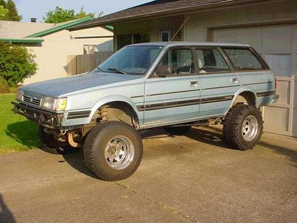

Jibs Posted March 29, 2006 Share Posted March 29, 2006 Here's a pic of an 8" lifted hatch, now owned by Turbone: It's got 8" blocks all around, thats about as much as I know. I say go for it, it'll look awesome. Do you have a t-case set up yet? I'd look into doing that while you've got everything else out. Have fun and keep us updated. Quote Link to comment Share on other sites More sharing options...

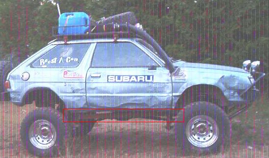

SakoTGrimes Posted March 30, 2006 Share Posted March 30, 2006 Is that a truck frame? Quote Link to comment Share on other sites More sharing options...
soobmater Posted March 30, 2006 Share Posted March 30, 2006 Jareds wagon,aka Rooinator 8 inch lift. ur welcome :-p and sako, its not a truck frame. Yes john did build rooinators lift. Quote Link to comment Share on other sites More sharing options...
Numbchux Posted March 30, 2006 Share Posted March 30, 2006 no, the beast is not swapped onto a truck frame. those are there to mount the tcase, as the unibody cannot take the torque in it's stock form I forgot about rooinater! He's tcased too IIRC in fact, I attached a pic of the only subaru I can think of with a custom lift over 6" that isn't tcased! It was for sale here a while ago, and I heard it ended up in MN, but I don't know anything else. Quote Link to comment Share on other sites More sharing options...
scrap487 Posted March 30, 2006 Author Share Posted March 30, 2006 no, the beast is not swapped onto a truck frame. those are there to mount the tcase, as the unibody cannot take the torque in it's stock form I forgot about rooinater! He's tcased too IIRC in fact, I attached a pic of the only subaru I can think of with a custom lift over 6" that isn't tcased! It was for sale here a while ago, and I heard it ended up in MN, but I don't know anything else. oh what a beautiful oil pan... and YES I KNEW I had seen an 8" lift on a wagon before, when I first joined the board thats what I was looking for and I had the hardest time finding anything higher than 4" for wagons and I was actually kinda stumped. ok, if I can find a tcase that would be great. if I do that though, does anyone know of a tcase that will work that has some sort of gear reduction in highgear? or possibly some differant differantials that I might be able to fit some better gears into? say like around 5:1 or something? or are those only found in solid axles... I suppose at the very least it wouldnt be too hard to make some 4.44 differantials work right? the reason I bring this up is because I have noticed that the on the tailshaft or whatever in the transmission have had a tendancy to shred to peices because of crawling with the transmission in low range all the time pushing those big tires. I guess ultimately I would try to make a nissan or if possible toyota 4 speed(those things are indestructable...) work with an ea81 if my transmission ever failed but i'd like to avoid that if possible. Quote Link to comment Share on other sites More sharing options...
