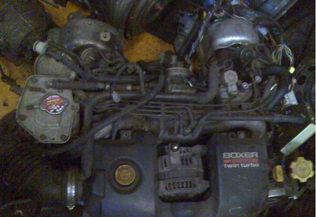

  20. Sup, Need help, want to change my 91 Leone's Ea82 Engine to an Ej Single turbo or twin turbo Engine. I know the single turbo engine can go in, but will the twin turbo go in. Check the twin turbo pic plz. Thanks
