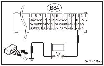

Evap System code.......frustrating!
OB99W replied to skibumm100's topic in 1990 to Present Legacy, Impreza, Outback, Forester, Baja, WRX&WrxSTI, SVXYes, it's a bit tight in there. A couple of hoses (in addition to the ones going to the purge valve itself) may have to be disconnected to make life easier. That's one of the reasons I'm holding off on the dancing banana. By the way, Gregg, if you get as far as installing the new valve where the old one was, the correct torque for the bolt is only about 12 ft-lbs.
OB99W replied to skibumm100's topic in 1990 to Present Legacy, Impreza, Outback, Forester, Baja, WRX&WrxSTI, SVXGregg, I'm glad I was able to help move things along. However, how about if I don't " " until the problem is fully resolved?
OB99W replied to skibumm100's topic in 1990 to Present Legacy, Impreza, Outback, Forester, Baja, WRX&WrxSTI, SVXExactly! The vent and purge valves do seem to get people confused. Let's hope! For future reference: The ECU connector pins are numbered consecutively. For example, continuing past pin 30 for five more, you'd be at pin 35. The last one in that row is 44; the count then jumps down to the beginning of the next row, beginning at 45, etc.
OB99W replied to skibumm100's topic in 1990 to Present Legacy, Impreza, Outback, Forester, Baja, WRX&WrxSTI, SVXYes, half the connector is shown, being back-probed (see the lower left depiction in the diagram I posted). Answered above. Right beneath the cylinder #3 portion of the intake manifold. (Cylinder #3 is left/rear when facing the engine from the front of the car.) It may be easier to spot if you stand at the passenger side fender and look from the rear of the engine. The main relay supplies power to several things; if it were the problem, we wouldn't be discussing P0443. Yes, and light at the end of the tunnel probably isn't from the headlight of an oncoming train.
OB99W replied to skibumm100's topic in 1990 to Present Legacy, Impreza, Outback, Forester, Baja, WRX&WrxSTI, SVXYes, P0443 is for the purge valve. No, the purge valve is not the one at the canister (that's the vent control valve). More to follow...
OB99W replied to skibumm100's topic in 1990 to Present Legacy, Impreza, Outback, Forester, Baja, WRX&WrxSTI, SVXAFAIK, not all the time -- otherwise, what would be the point of having the ECU control it? Checking resistance in a powered circuit is almost never a good idea; things can get damaged, and the readings are rarely accurate. The proper way to test is via voltage readings under operating conditions. ECU Pin 72 should pull down to below 1 volt when the purge control is activated. P0443 is "EVAP System Purge Control Valve Circuit Low Input". I added the emphasis because that would seem to indicate that your ECU is not seeing battery voltage (greater than 10 volts) at Pin 72. You said "I backprobed the ECM plug on the correct wire and had 11.8 VDC at the ECM with the KOEO."; assuming that means you made the measurement right at ECU pin 72, it should have seen sufficient voltage. Is there any possibility that the ECU connector (B84) isn't making good contact? You seem to have tested for the things the FSM suggests (voltage, wiring opens, solenoid resistance, etc.). The first test in the FSM is for greater than 10 volts at ECU pin 72 with key ON; if that's there, the FSM indicates that even if the MIL is lit, "the circuit has returned to a normal condition at this time" and "probable cause is deterioration of multiple parts". I'm not sure I agree with that second quote, however. I'm not certain about this, but D-Check mode may cycle the purge control valve solenoid. You could try warming the engine, shutting it down and connecting the green under-dash connectors, then run D-Check. Monitor the voltage across the solenoid while D-Check is running.
OB99W replied to skibumm100's topic in 1990 to Present Legacy, Impreza, Outback, Forester, Baja, WRX&WrxSTI, SVXActually, the following is your previous post concerning this problem: http://www.ultimatesubaru.org/forum/showthread.php?t=77287 The original discussion began here: http://www.ultimatesubaru.org/forum/showthread.php?t=60858&page=2
