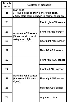

ABS codes website? Antilock brakes
OB99W replied to unibrook's topic in 1990 to Present Legacy, Impreza, Outback, Forester, Baja, WRX&WrxSTI, SVXFor the codes you mentioned, see attached. I'd suggest checking the resistance of those wheel sensors; they're typically around 1.2-1.3 kohms.
