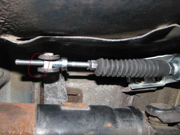

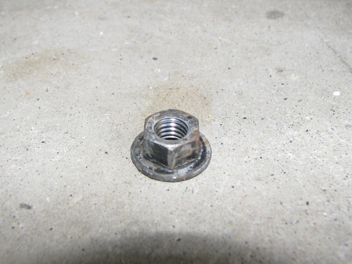

(Oops... should have said shifter cable in the subject. Wish I could edit those after the fact...) Just put in a new shifter cable in my (new to me) 1997 Legacy LSI, 2.5l engine. The PO drove the car for a very long time with the cable so loose that you could push the car into reverse without any kind of override. So, I don't trust that he did things 100% by the book and think the old nut may have fallen off and been replaced by a hack. The question I have is about the nut that should be on the left in the red circle. I've looked through my manual and the parts diagram from Subaru and the pics are either too small, grainy or are missing this detail: The PO had this nut on the end and it was very loose: It has a built-in washer that spins and it spanned all the way across both parts of the fork in the top picture. It locked the end of the cable 100% to the fork -- no wiggle at all. This doesn't seem right to me in that cables generally have the ability to wiggle/rotate a bit, and it seems like it should be locked to the aluminum piece in the center of the fork instead. But... that would be aluminum wiggling against steel. Here's the broken rod and the old nut that was on it: BTW, The cable came from Subaru with just the cable and a new long nut. So... anyone know what goes on the back end of the cable? The old washer from the PO? Another long nut that would lock the aluminum pivot between two long nuts (I have the old and the new.) Something else? As always, thanks for your help.

bendecker replied to bendecker's topic in 1990 to Present Legacy, Impreza, Outback, Forester, Baja, WRX&WrxSTI, SVXHah! Just found a parts diagram that i believe is from another year. It looks like the others I found for my year were cut off at the right: It shows what looks like that nut with the spinning washer built in. I'm still not sure what a "grommet sheath" is, though: Found it here: http://www.subarupartsandaccessories.com/showAssembly.aspx?makeName=subaru&modelYear=0&modelName=forester&ukey_assembly=6029508&ukey_category=54100&assembly=s11-351-01
1997 Legacy -- tranny cable adjustment with odd issues
bendecker replied to bendecker's topic in 1990 to Present Legacy, Impreza, Outback, Forester, Baja, WRX&WrxSTI, SVXThat tube is the long nut (silver in the pic above). What it doesn't show is an opposing nut. You are right that the white/silver section in the middle is the aluminum piece that pivots just a bit. It doesn't move move much. They say in the manual to torque down the nut, but they don't show what the opposing nut should look like. Nor does this diagram: It looks like using two of the long nuts will work fine, but I'd bet that is not what was in there originally. There is a little part #35151AC030 they call "GROMMET-SHEET D30" in the diagram. Maybe that is a tube that goes around rod on the left side of the sliver pivot in the fork, followed by a nut on the left side...?

bendecker replied to bendecker's topic in 1990 to Present Legacy, Impreza, Outback, Forester, Baja, WRX&WrxSTI, SVXI got the new part in. (Side note for anyone ever doing this -- if it looks right, but the cable on the right side doesn't pull back far enough, you have the bracket on the right in backwards. Looks perfect, but it isn't). I have a question about the nut that should be on the left in the red circle. I've looked through my manual and the parts diagram from Subaru and the pics are either too small and grainy (manual) or not detailed enough to see how things together (parts diagrams): The PO had this nut on the end: It has a built-in washer that spins and it spanned all the way across both parts of the fork in the top picture. It locked the end of the cable 100% to the forks -- no wiggle at all. This doesn't seem right to me. Cables should have the ability to wiggle/rotate a bit, and it seems like it should be locked to the aluminum piece in the center of the fork instead. I think the total lack of wiggle room is why the last one failed by breaking the threaded rod that the nut goes on. Here's the broken rod and the old nut that was on it: I'm thinking that it should be on the left, mirroring the shiny new one on the right. Crank them together so they are tight against the aluminum piece. Anyone know how this really should be? Was the the PO's nut wonky? (Make up your own jokes for that one... ) Is the mirroring of the old nut and new nut the way to go? Thanks, as always.

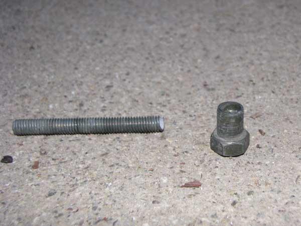

bendecker replied to bendecker's topic in 1990 to Present Legacy, Impreza, Outback, Forester, Baja, WRX&WrxSTI, SVXOk. First, I get the bonehead award. I was working in very confined quarters and had the shifter lever and the tranny levers under the car reversed in my head. DOH!! Now that the cable has broken, yes, I can move the lever on the side of the tranny and the shifter inside easily. I think you are 100% right that the cable was just super corroded inside. Now to find a new one. I could pull one from my old car if a '96 works in a '97 (likely)
bendecker replied to bendecker's topic in 1990 to Present Legacy, Impreza, Outback, Forester, Baja, WRX&WrxSTI, SVXSomething that I should have added to all of the above: the shifter has been very difficult to move to lower gears, getting worse as it went down. So, now I've got a bigger mess. I was trying to adjust the cable again this morning and the thread part at the end of the cable -- not the cable itself -- broke. I was working the shifter back and forth and it suddenly became very loose. [[ EDIT: I was confused. The tranny lever can be moved by hand and the shift lever is fine. This is probably the cable -- see entries below. ]]
