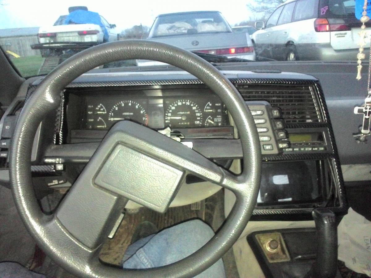

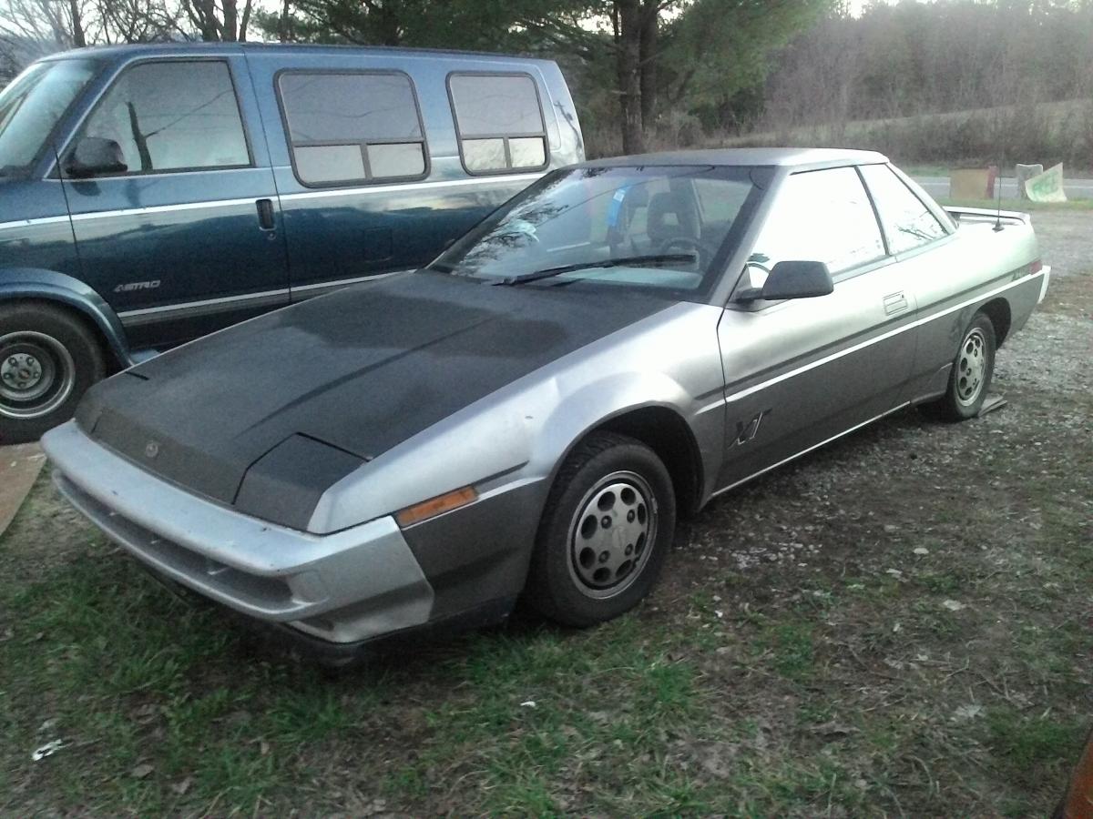

  24. Thought I'd toss up a couple pics of how the car sits now. I'm not gonna mess with the motor or trans, i kinda like 40mpg in a daily driver lol I'm working on a digi-dash conversion and some add on digital gauges to complete my all glass cockpit concept. I have Corvette Night Race Blue paint for it as soon as i get the weather

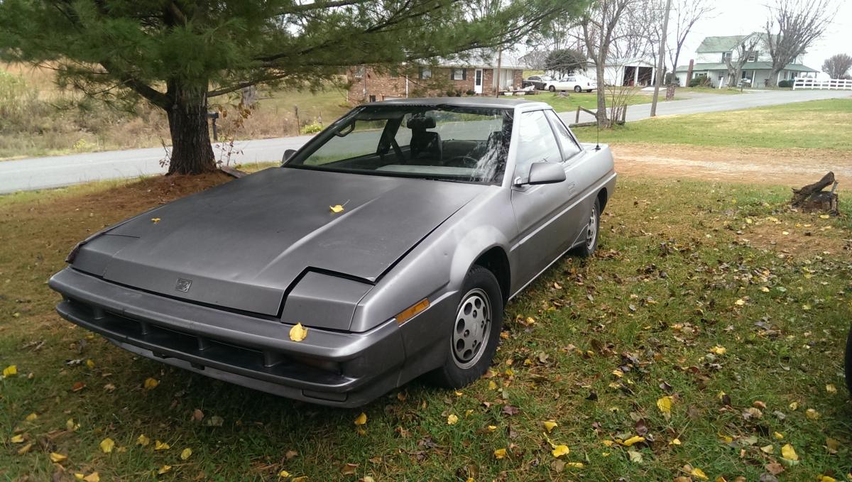

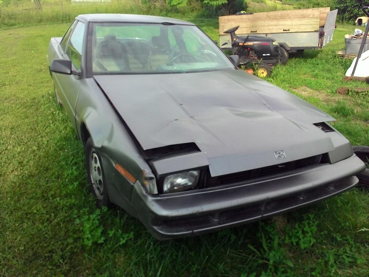

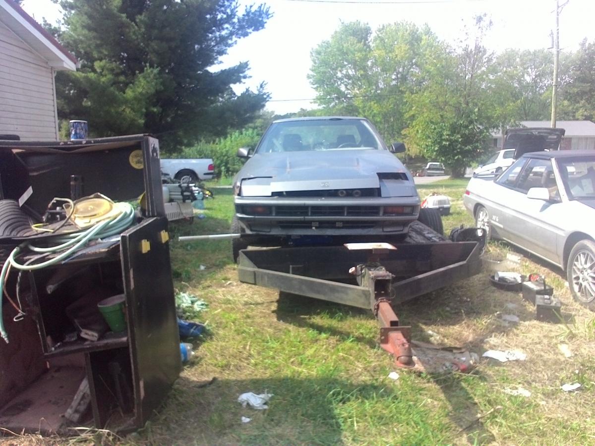

  25. All my pics didnt load, so here goes... 1st pic: The day I got her 2nd pic:That's how crooked the front bumper was. I used the trailer as a makeshift frame jig to pull it out. 3rd pic: The damage from the hood latch going rogue
