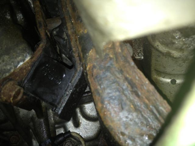

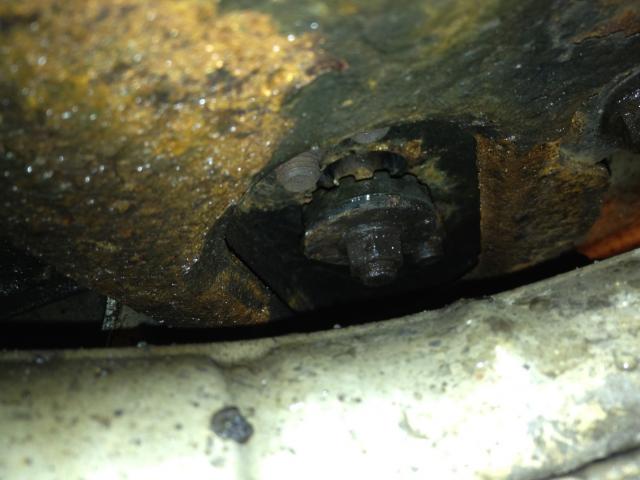

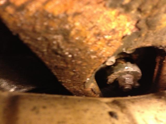

2003 4EAT, this a bad trans mount?
The side blocks don't look bad, but the center support is drooping by about an inch. I pulled down on it all, it will pull down a little more, so I don't think it's metal on metal, and therefore is not the source of my pinion-noise (normal noise telegraphed metel-metal to the body). Do you have to pull the header to change the mounts, or just the 1st section after the header?
