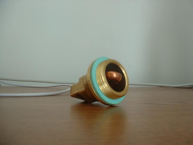

  1. finally, i was able to upload this picture so if i drain the head should i fill up at the thermostat, then fill the radiator i'm also going to flush the heater core, and replace any hoses ,clamp i also have a waterpump on order so i want to make sure i do this right because this block heater sits in there horizontally and is concave i want to make sure i dont trap air
  2. ready to put in this block heater, and thermostat but worried about trapping air in the block heater and in the cooling system i've successfully changed thermo on a EJ25 would the purging of air with radiator cap off be the same for my EA81??? any tips would be appreciated

  16. does this block heater that goes next to the crank pulley on an EA81 go into the coolant jacket if so i'm going to replace the thermostat at the same time

  19. thanks subiemechanic85 so for an EA81 i just have to find a block heater with 36mm thread YEAH:lol:now Hero can wake up
