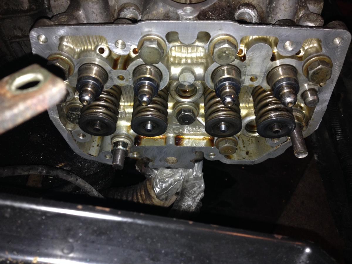

So here is a picture of the head. All frankensteined up......... Showing it's (threaded rod) poppin' out itz neck...... Initially, It was only one striped taping in the block at Bolt#5... Then as I was tightening... at the last torque sequence... The other one blew out.... (lower right) #8(i am guessin').... So I had to do that one..... I did that one while the head was still on...... cut some more rod and threaded it in. I ended up only finding grade 7..... rod... it is 7/16 fine thread..... I cleaned the debri out of the the taping with a tiny screw driver and just threaded it in... It was a little nerving.... When to decide to stop threading it in... I did measure carefully, buy still it was hard to tell when.... It was done.. due to how it felt..... and well, you only get one try at this.... I double nutted the rod and cranked it in..... I used the conventional flat washer the was origininally there and put a lock washer on top of that..... It seems to be holding...... So I believe this occurred due to excessive heat..... It has been cold here, but I got stuck in traffic on the highway a couple of times... and she got hot above the halfway mark. not into the red but, close... maybe a 1/4 inch away....... My thermostatic switch had failed..... so electric fan was not coming on.... I had ripped out the AC and the mechanical fan........ So I think this is a story with a happy ending..... car is running good......... If it fails.... I will add to this post.....
