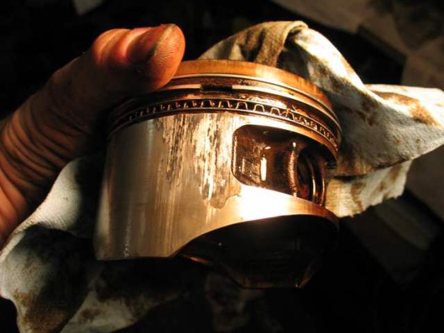

  1. My guess is a really hot engine getting stopped, cools off and then started again? Anyone else seen this? Also, most of my pistons have scratches down the sides below the rings, what causes this, is it bad? Can you just replace a single piston or should I get a whole new set? Anyone have input on running forged (turbo) pistons in a non-turbo car? Anyone tell me how to replace the pin bearing on the upper part of the connecting rod? Links to the bad piston pictures: http://www.ultimatesubaru.org/forum/attachment.php?attachmentid=2034&stc=1&thumb=1 http://www.ultimatesubaru.org/forum/attachment.php?attachmentid=2035&stc=1&thumb=1

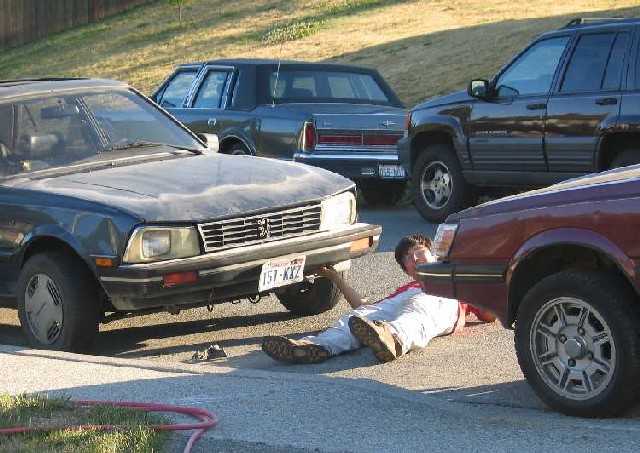

  18. Well after looking around for 15" PUG's I finally found what I was looking for. I tried to buy some off a guy on this site, but he never got back to me. I looked at PAP but never found a complete set. Well Saturday at the auto auction (tow lot) I saw not one but three 1986 Pegout 505's. I figured I would bid a max of $100 since thay all had good rims and drivable tires. The first one up for auction went to me at a starting bid of $60!!!! The second at $65, the thrird (with the best tires and rims) for $70. Wholly cow I said when I got the first car at the start bid price, I should have held out for the last one, little did I know. I lined up a tow to my house, but after I paid the $15 to get a key made it sparked up. I drove it to my house and had the tires swaped out in nothing flat. I had to reverse my old 13" to get them on the Peugot. I also had to take the rear brakes off the back tires to get them to spin. I then donated the old Peugot to and am going to write it off on my taxes! Anyway, here is a shot of my two cars with the rims swaped. Also the tranfer to prove, $60+$5 taxes. Total investment: $80 ($15 for a shaved key) Return: Tax write off and new 15" rims. I figure I got 1/3 of the tread left. What are the best tires to get on these? I don't mind the larger rolling radius, I have P155/60R15 on there right now. I'm getting a 2" BYB lift so I'm looking for a tall ride. Advice???
