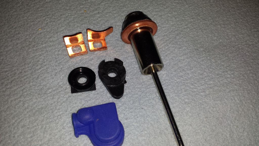

Ordered this today http://www.ebay.com/itm/281127989860?ssPageName=STRK:MEWNX:IT&_trksid=p3984.m1497.l2649 I really needed just the plunger but I will just replace everything again, it's super easy to get to the starter anyways.

1-3-2-4 replied to 1-3-2-4's topic in 1990 to Present Legacy, Impreza, Outback, Forester, Baja, WRX&WrxSTI, SVXFor those that want to know I ordered this starter kit. http://www.ebay.com/itm/281127989860?ssPageName=STRK:MEWNX:IT&_trksid=p3984.m1497.l2649

1-3-2-4 replied to 1-3-2-4's topic in 1990 to Present Legacy, Impreza, Outback, Forester, Baja, WRX&WrxSTI, SVXI guess I should replace the plunger then And yes I did get the car started.

Turns out it was the starter.. I replaced the contacts but not the plunger about two years ago.

1-3-2-4 replied to 1-3-2-4's topic in 1990 to Present Legacy, Impreza, Outback, Forester, Baja, WRX&WrxSTI, SVXDamn starter contacts out again.. replaced them year before last but not the plunger
