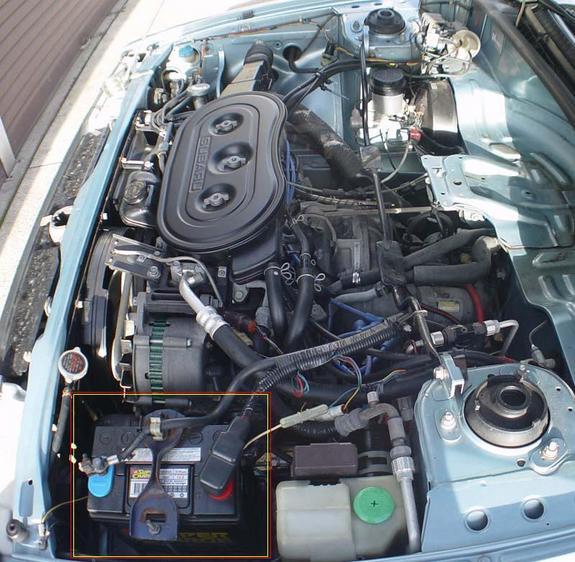

Hey, folks, I think that this might be the ground wire that connects to the radiator, but where? It looks like it might fit exactly on the nearest radiator fan shroud bolt. Anybody have a picture of how/ where this connects? OR, if you have a similar vehicle, can you check yours and see where the "business end" of that ground wire connects? Thx! Subaruru

Dear subiemech85, I have a NEW question RE grounding (anyone may jump in here, as long as s/he is knowledgeable about the issue at hand!), I had someone help me replace a rusted-out heating/cooling system pipe, and he doesn't remember where goes the ground wire extending from the frame around the engine bay, just in front of the battery (1986 GL loyale, EA82, 2bbl carb model engine). It looks like it might connect to the alternator, but I'm not one for Russian Roulette when it comes to electrical stuff! You can see, in the image linked to below, what looks like the same ground wire setup that extends (in the linked image) from the blue frame just to the left of the outlined square that highlights the battery, where the wire in question seems to duck down into the engine bay in front of the battery [which is exactly what it would do on my subie if I connected it to the scew/nut assembly that allows the alternator (I think it's the alternator - it's the smaller belt-driven gizmo just underneath the larger, belt-driven gizmo on top) to slide outward and upward in order to take up the slack in the belt]. Thanks much to any and all who can clear this up, thus helping me to avoid what might otherwise be a costly round of Russian Roulette! Here's the image in question (the gound wire in question is located in the bottom left-hand corner of the pic... OOPS! You'll have to scroll down a bit to see the image, the link to the separate JPG image itself failed! Nope, it failed too - I uploaded the image myself!!!). Thanks again! subaruru
