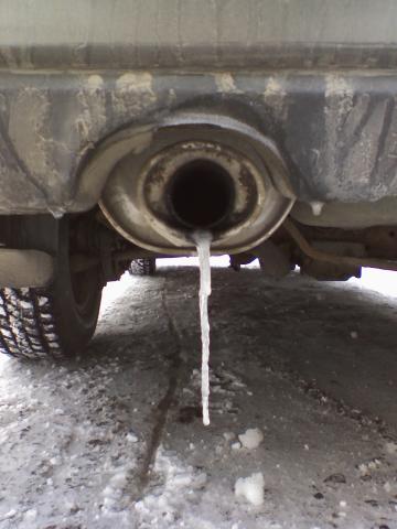

efseiler replied to efseiler's topic in 1990 to Present Legacy, Impreza, Outback, Forester, Baja, WRX&WrxSTI, SVXI used a pretty copious amount in the tank and after about 1000 miles of driving the backfire/sputter is almost gone. One thing that also happened was one of the thin EGR hoses popped off the solenoid? I think it was. There was a lot of black carbon dust that spewed over the engine. I cleaned the EGR valve assy with a pipe cleaner and now the engine is running better than ever. Seafoam is a product that really seems to work....:-) I would also re-recommend Shell gas as the difference is horsepower and pickup is really very noticable. Other brands use more ethanol/methanol and sometimes even mix in a little water. I've been using 'Startron' which bills itself as an 'enzyme' cleaner. When using cheap gas I noticed a slight increase in pickup/hp. Another thing I noticed was in the exhaust...it was 'puffier' (if you will) and no dripping water out of the tailpipe. (see attachment) --Damien
