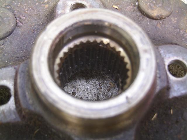

I need to replace a splined hub on my wagon (the part that the lug studs are mounted to) and was sent one with a lip on the inside where the splines are. The ones that came off the car have splines nearly to the edge of the cylindar. I have a feeling they won't work, but thought a check here would do me some good (I attached a pic for reference.) Anyone?
