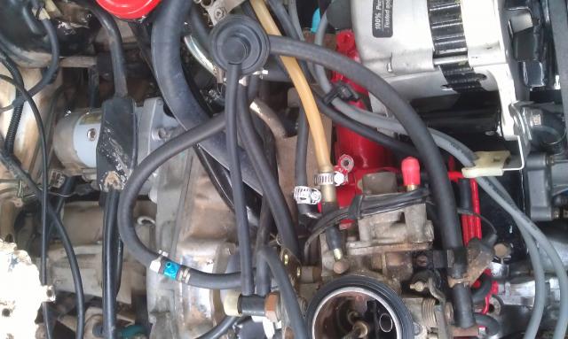

  12. So I got 2 air control valves, One with: 2 ports, one large, one small, pointing opposite of each other (not in pictures) Second with: 4 ports, all large, three pointing one direction, 1 pointing the opposite (in pictures) Also I have a, looks like a solenoid valve with 2 small ports (in pictures) I had it running great, however, it was at a higher idle. So, I started playing with this stuff, bad mistake. I eliminated the charcoal canister. I still have the Anti afterburn valve and EGR. I have taken the lines off the carb and air control valves and got them and rearranged and all mixed up. What do I do? What can I cap? what is needed? I do I get this routed right? Any diagrams or pictures you have? I looked in the haynes manual and searched this diagram, no luck on routing diagram Sometimes is starts right away, runs decent (when hot). Seems to starts every time cold and run decent. Weird huh, normally its opposite in most cars Check out the pics, how do get this routed right, so it will start every time hot or cold. If you pics of your engine bay while explain, that would most helpful. Thanks in advance.

  16. I checked the choke for poops and giggles and it is functioning properly. It was running great without the pods, however, I think I will throw them back on there. It seems a lot of the emissions have no value, but these do have value. Once I get those thrown back on there I am gonna mess with the screw again. Thanks.

  18. If those are the UFOs looking things, I took those off a week or so ago. It ran great until I messed with the bottom screw. I could try to put them back on (like you said earlier) and "T" them together, if you think it has value

  20. They seem darn tight on there. I dont think there are to many vac leaks, they may resolve the high idle issue, not the adjustment screw issue
  21. It is the stock carb, I eliminated all the emissions crap prior to messing with the screw. It ran great without all that ************, and cleaned up the engine bay Everything is capped off with new caps, and I put new vacuum lines on there. The few that are left.
  22. Not quite two turns? Do you mean turn the all the clockwise tight, then back off almost 2 complete turns. Or thread all the way off, then turn clockwise 2 complete times. I didnt mess with the ignition timing at all. New plugs, wires, cap and rotor. It ran beautiful, but a little high idle until I messed with that screw. After looking in the haynes manual it is the "secondary fast-idle screw", it says to adjust it to angle, not sure how to measure the angle.
