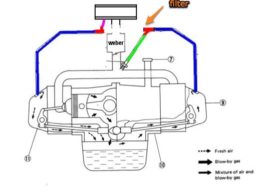

  5. I made it as the picture shows. Just testing, I put a paper towel over it as a filter and took it for a ride. That worked, no sucking oil. I will reduce the diameter and go that route. Thanks again.

  9. Which is why I asked. I "think" I am sucking oil. Would this correct the problem?

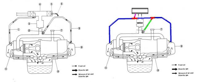

  11. Anyone see anything wrong with this? The right photo, with the Weber.
