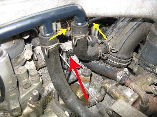

The photo is taken from the back of the turbo intake duct. It was my understanding that the AAV is in the front of that duct, and has an electrical connector just like the CTS on top. If my understanding is correct, then the unit in the photo above, and according to my Haynes manual, is in fact the EGR solenoid valve. I haven't ever gotten a code regarding the AAV or the EGR-SV. I guess it must not matter much that the latter isn't connected. However, that valve does have two plastic connectors on it that are broken off, so I do believe that that's where they go. Otherwise, the metal line might be part of the fuel injection system in which case I would have fuel spraying on top of my engine . So that's obviously not it...

Since we've already touched on this in this topic, I was hoping that someone here might know that this other mysterious little unit is right under the turbo intake duct (red arrow). The disconnected hose and the metal line (yellow arrows) both are supposed to hook up to this I think, but both plastic connections on the unit are broken. It has a couple of wires going to it on the left side that you can't see here. EDIT: Aha! Actually found info on this in the Haynes manual! That would be the EGR Solenoid Valve. Probably good to have that working maybe?
