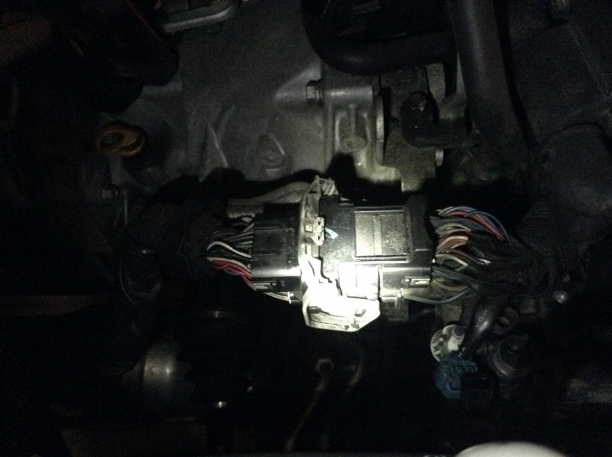

I know how to rotate the grey lever rearward, which pushes the rear connector back, but how do I separate the connectors?- Brat Blower Motor Relay~Problem solved!
