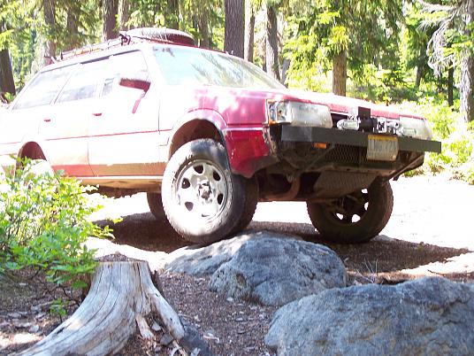

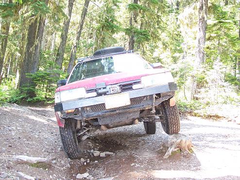

heres my subie!!!
what it has -roof rack/ boat rack -LSD -rear disc brakes -weber carb -205/75/r15 tires -6 lug toyota hub conversion -1/4inch thick channel steel front bumper with 3,000 lb. winch whats left -rear bumper -2.2 conversion -paint job and also a thanks to earl for all of his help with my rear disc brakes and lsd, couldnt have done it with out your help.
