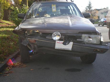

Haha, I forgot to check the speedo as I hit. I would say probably 35ish at impact? Yeah, the release cable is immobile, I'm going to be trying to take out the bolts. I can get at least flat wrenches in on both sides, I think. What a week.
I avoided a worse accident on the freeway yesterday, but in doing so put my 86' GL wagon into a concrete barricade at decent speed. Caught a little air in the front from the impact, and it turned the engine off. Engine won't turn over, sounds bound up. My neck and back are sore, but I'm mostly alright, health-wise. Not much forward of the firewall looks salvageable, but we'll see after I figure out how to get the hood off. I haven't parted out a car myself before, can anyone give me advice on how to figure out if the engine is still functional or not? Any other advice is great too. I know GD has saved a couple car with wrecked subframes, but this one seems a little far gone to me. I've got some feelers out right now, and have shot a couple emails on craigslist. I guess if my engine is alright, I'd be trying to find something that needs one and swap it in. At some point I'll be parting out whats left of it. Bummer.
