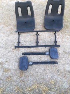

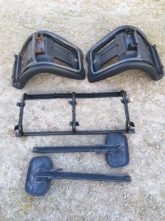

  2. I have a good set of Brat seats with all the hardware.the seat belts are a little iffy but with some determination i think they could work...$200 bucks for the whole deal ..Thanks.Hope i posted this in a right spot,Todd
