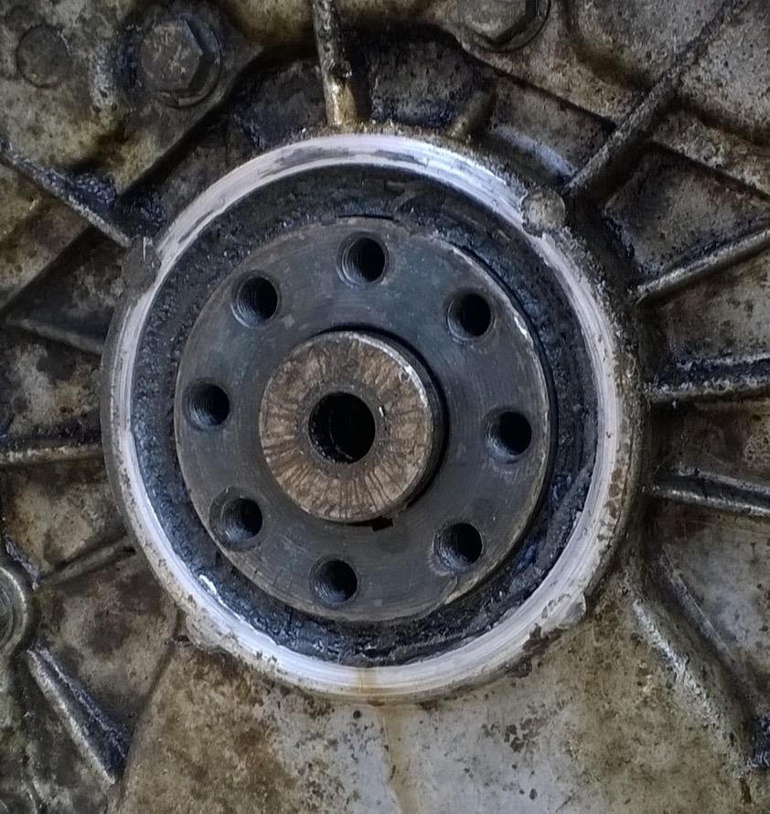

  1. Yep,When they changed the 1400 to a 1600 they needed to change the 1400 bell housing to the 1600 engine....and the flywheel too, I am guessing.So on the back of the flywheel was a raised rib that rubbed on the bell housing casing around the rear crank seal hole,now that caused enough heat that the bottom of the crank seal was out of sink....sinc ? Anyway we fixed it with a rat tail file. Boy it sure looks funny when you write it down.... Rat tail file ? haha it sure does look like one... So..I chased down another rear seal and we will see..Boy what a head scratchier ?/? Ever heard of The Model Garage from Popular Science magazines? From 1929 to the early 1060 they had a monthly Automotive mystery. Gus Wilson was the Mechanic that solved the mystery's...This could have been one of them ......!

  4. So i am working on a 1974 Coupe with a aftermarket 1600 in it..I can't seem to install the rear crankshaft seal...I have installed many 1600 and 1800 without any problems... It seems the seal is just a hair too big and will just not go in without tearing the outer rubber on the seal...hmmmmm? I think the bell housing is a 1400 as it doesn't match any of the 1600's I have laying around here..From what I can tell the 1400 and the 1600 use the same seal....I was hopeing the 1400 was just a scosh smaller but no...(Insert sad face).Well any thoughts? Thanks ,todd this is the original seal...
  5. No the picture didn't work but i posted it on a new post about crankshaft seal..really ugly.......Well i opened it up and sure as toast the rear seal is leaking..And the 1400 and the 1600 uses the same seal...Hmmmm So now what do i do? Anyone have any trouble like that?
  6. rear sealWell we open her up and found the rear oil seal was toast.It looked like it was pushed in too far and someone just filled the gap with blue sealer. So we cleaned everything up and tried to install a used(hey I know but it was one I installed only a few years ago) in the 1600 set up. well it wouldn't go,I ended up tapping so hard it tore the rubber off the outer ring of the seal.I have honestly installed dozens of Subaru rear seals and never had this kind of problem.So I ordered a new one for the 1600 ,I used fine sandpaper and cleaned the bell housing where the seal sits,Didn't look bad...So I go to install the seal and ....Dang it just doesn't fit maybe a 1/16 or 1/32 over? I end up tearing the outer side of the seal..... Hmmmmm well its installed and it just has to work.....yea right haha.so we install the engine and ,..........Its dumping out oil from that seal..I'm guessing ,haven't open it up yet but it seems that way. I coated the flywheel bolts so thats good.... So this rig had a 1400 that was swaped to a 1600. So I thought mabey they used the 1400 bell housing on the new 1600 so it will work ??? again just guessing.and that the 1400 seal was smaller than the 1600.and that would explain the mystery...Nada !I looked all over on line to see if they were the same gasket ......and it appears that they are the same..(insert puzzled,suprized face).Soooooo I plan on calling some of the supply houses and see what up ? The engine has been split at some point,you can see ample sealer everywhere..Did they use the 1400 bell housing to adapt the 1600's in? Any thoughts? thanks todd did the picture work?
