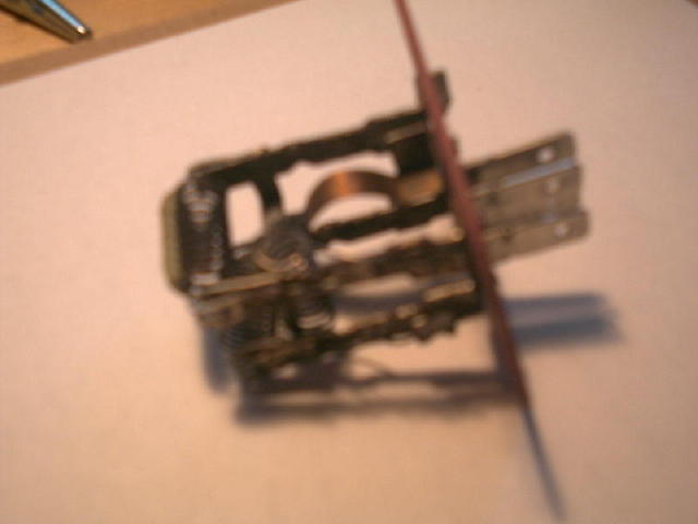

Blower resistor solder
gcleeton replied to gcleeton's topic in 1990 to Present Legacy, Impreza, Outback, Forester, Baja, WRX&WrxSTI, SVXYes I have attached a picture of it. It is bronze color shaped like an inverted U. Thanks for your patience. Sorry pic is blurred I do not have the latest camera! Gil
gcleeton replied to gcleeton's topic in 1990 to Present Legacy, Impreza, Outback, Forester, Baja, WRX&WrxSTI, SVXYes but it isn't a coil it's a U-shaped strip of metal about an eighth inch wide and an inch circumference?
The blower resistors periodically fail in both my 96 and 99 Legacies.(I have the circuit if anybody wants it). In most cases it is the soldered joint which melts, and only occasionally the coils break. Why is there a piece of highly curved springy metal connected with a soldered joint to one of the resistors? The metal does not appear to be a bimetal strip. Is the melting-point of the solder being used as a first-line protection to save the coils? If not, I intend to use higher-melting point solder or braze the joint? Gil

Blower resistor
gcleeton replied to gcleeton's topic in 1990 to Present Legacy, Impreza, Outback, Forester, Baja, WRX&WrxSTI, SVXSORRY ABOUT MISTAKES IN LAST MESSAGE - HERE IS THE HOPEFULLY CORRECT ANALYSIS - I HAVE A UNIT DISMANTLED HERE ON THE BENCH - You can prise off the cover and twist the lugs straight underneath so you can take off the perforated screen. With the keyway at the top, renumber the pins top left 1, top right 2, bottom right 3 and bottom left 4 (clockwise). Inside there is only one soldered joint check this first and resolder if necessary - this has melted twice in one of my units. All other joints are crimped because nichrome resistor wire is difficult to solder. The circuit I think consists of 0.5 ohm between 1 and 4, in series with 1.2 ohm between 4 and 3, in series with 2.2 ohm between 3 and 2. These three resistors are therefore joined in series. Phone me 716 373 1015 or email gcleeton@hotmail.com for a pic or help. Sorry I got the pins wrong in last email. What a crude unit and what a crude method of control - there must be a better way. Fancy having to force-air cool it, or the resistors would be a foot long like sausages! Gil
