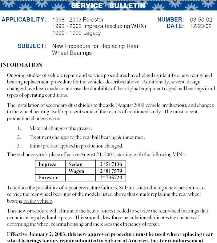

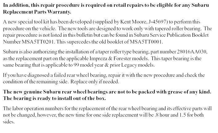

I see from attached Subaru service bulletin that Subaru changed specs from the 'Finger' roller bearings installed at manufacture to regular roller wheel bearings. I have the new part but I am concerned that the mating surface hub is radiused and that will destroy the oil seal it is against? That it will lead to premature failure? Anyone have any real word experience? Thanks!
