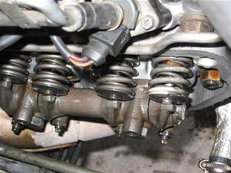

  21. Hey, I took off the rocker covers of my ea81t toady, just to ckeck the valve clearences.... and found this. White water/oil goo, concentrated mainly around where the PCV hose connects to the cover. The goo only goes about 2cm up the pcv hose, then its clean. As you can see, most of the rocker and valves are clean... just some milky stuff splashed on #1intake... I've never seen any sign of water on the dipstick.... but it does get small amounts of condensation at teh top of the oil filler tube.... Any thoughts?
