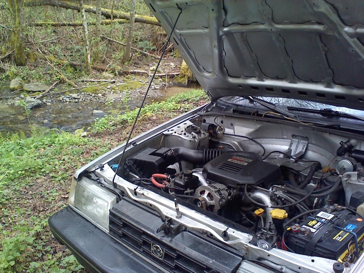

  12. As bout closing the bonnet u mean hood right lol as I am redneck all the way from the US and if I am right yes on stock height u can close the bonnet aka the hood lolIV EJed my 86 RX with no lift no problim

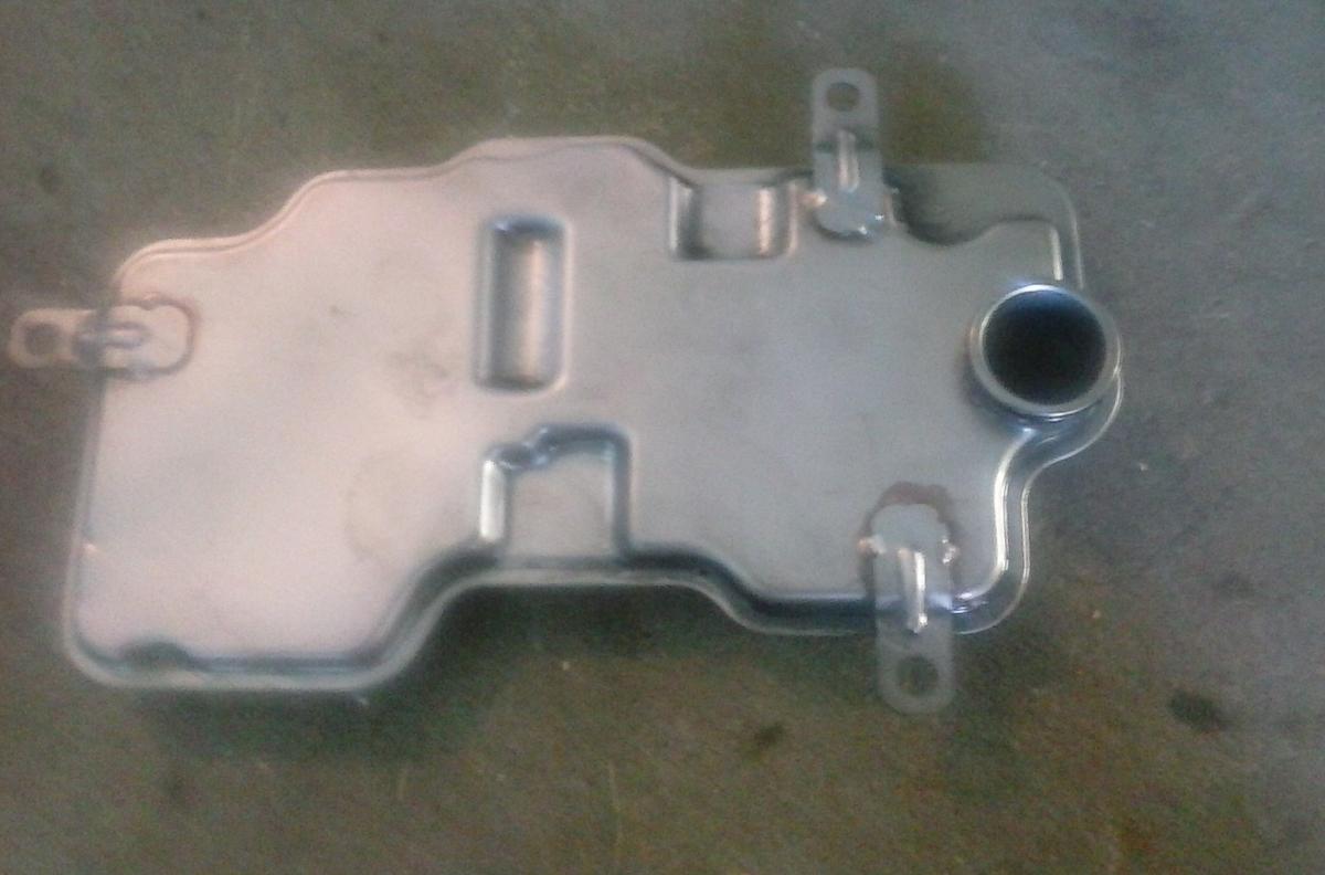

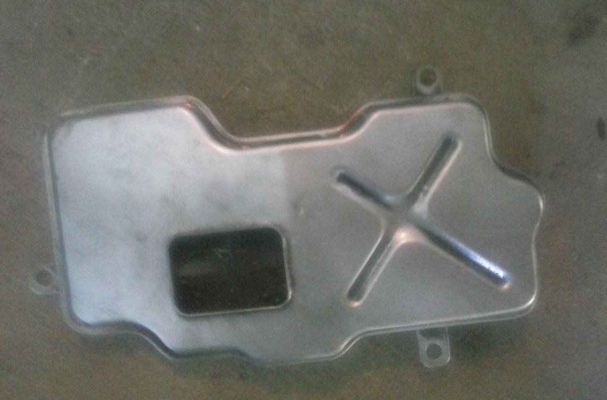

  13. okay my grandma purchased a 04 Forester she paid way too much for the car as it's been totaled before. it is the 2.5 liter non turbo automatic anyway the problem is I attempted to service her transmission but when I went to purchase the filter kit and we're talking the internal filter not the spin on the parts stores all come up with the wrong filter can anyone identify this filter it is the one that I pulled out of her transmission Maybe engine transmission has been swapped I'm not sure what's going on
  14. I run no T belt go off road all the time never have a problem those covers suck lol

  18. Very nice I dig the no timing belt covers can't see if my photo but that's the same thing I did Makes it way easier to change a timing belt don't even have to take the balancer off

  22. Sorry forgot to update u all about the car it's been fixed she is back to driving her car thanks to all u that gave me your 2¢
