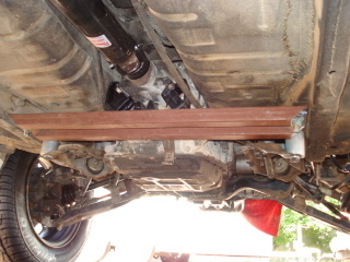

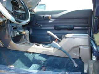

I'll take a look at that.... it may work out perfectly. The tranny is a bit tight but it does fit in there. I made a custom crossmember for the tranny mounts. I welded 3"x3"x1/8" plates to 2 cutoff 1/2" bolts. those come down through from the cab ( recessed in the tar paper so they're flush and won't spin) then on through the unibody ribs under the car. I used 1 1/4" .090 square tubing with plates for the tranny mounts and bolts. I have also used the entire shift unit and center consol. When I try to upload pictures it says they're to big. I set my camera for 480x640... thats the smallest I have.... if I can figure it out I'll post pictures of the swap in stages. THX bret
