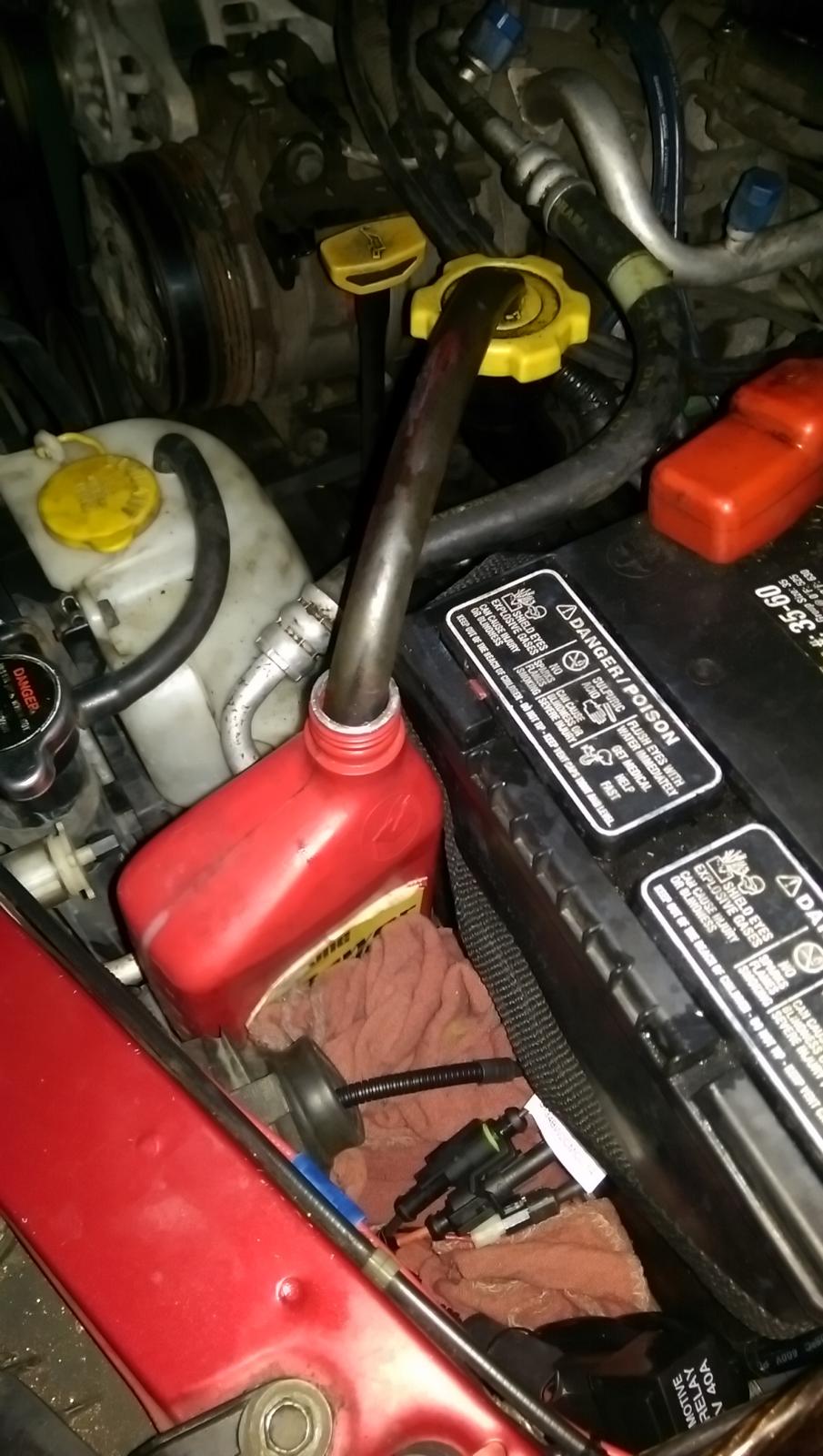

nicholi2789 replied to nicholi2789's topic in 1990 to Present Legacy, Impreza, Outback, Forester, Baja, WRX&WrxSTI, SVXHey quick question for anyone who can answer: Has anyone ever heard of putting a hole in an oil fill cap to relieve pressure? When I bought this car I noticed this. It has a 3/4 inch hole drilled into the cap with a little plastic tube coming out into an empty quart jug. I asked the guy about it when I bought car and he mumbled something about relieving oil pressure. Didn't make sense to me. I never replaced it because I didn't have another car to replace it with and didn't see what harm it would do. But yesterday I got a replacement fill cap at pick a part. Can anyone see any reason why this weird cap setupwas there? Or any harm in replacing it? I can see what that could be but just wanted to see if anyone saw something I didn't. Lol.- Heater fan working intermittently
