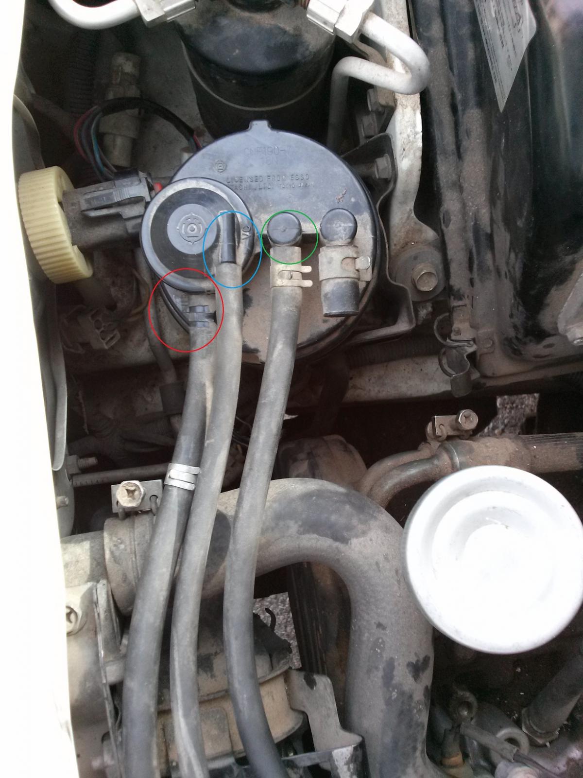

  15. Visuals always help me so here's this. The line circled in red on the left is the one that can't be sucked or blown through. The line circled in blue is the one that runs to the purge solenoid, and it seems to have plenty of vacuum. The third line, in green, from what I understand is the incoming line, which I blew into that one too and there was no air coming out either of the other hoses.
  16. Could it be the vapor canister, or the two way valve inside the vapor canister? Should the line coming from the purge valve on the canister have any air movement through it? I pulled that hose and gave it the old Lewinski, but there's absolutely no flow through it.
  17. First off, thanks for your response! This whole having to pass emissions stuff is fairly new to me, I grew up in the sticks and was never needed before. So, the purge solenoid is hooked to the vacuum vent line from the vapor canister(I think). I pulled the hoses off the canister and the one that leads to that solenoid(which is similar to and near the EGR solenoid) and that hose seems to have plenty of vacuum. The hose next to it, which connects right underneath on the canister (purge control valve itself I'm guessing) has absolutely zero air flow through it either direction.
