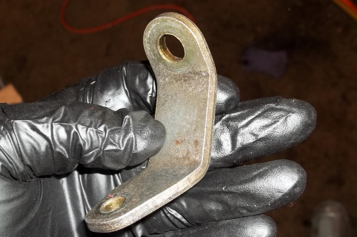

  15. Never mind, I found where it goes... It is the brace that goes from the oil filler tube to the bell housing
  16. EA81 So putting everything back together today, and found this little gem... Any guesses as to where it goes? Im guessing it acts as a support of some kind between the engine and tranny, but not sure.
