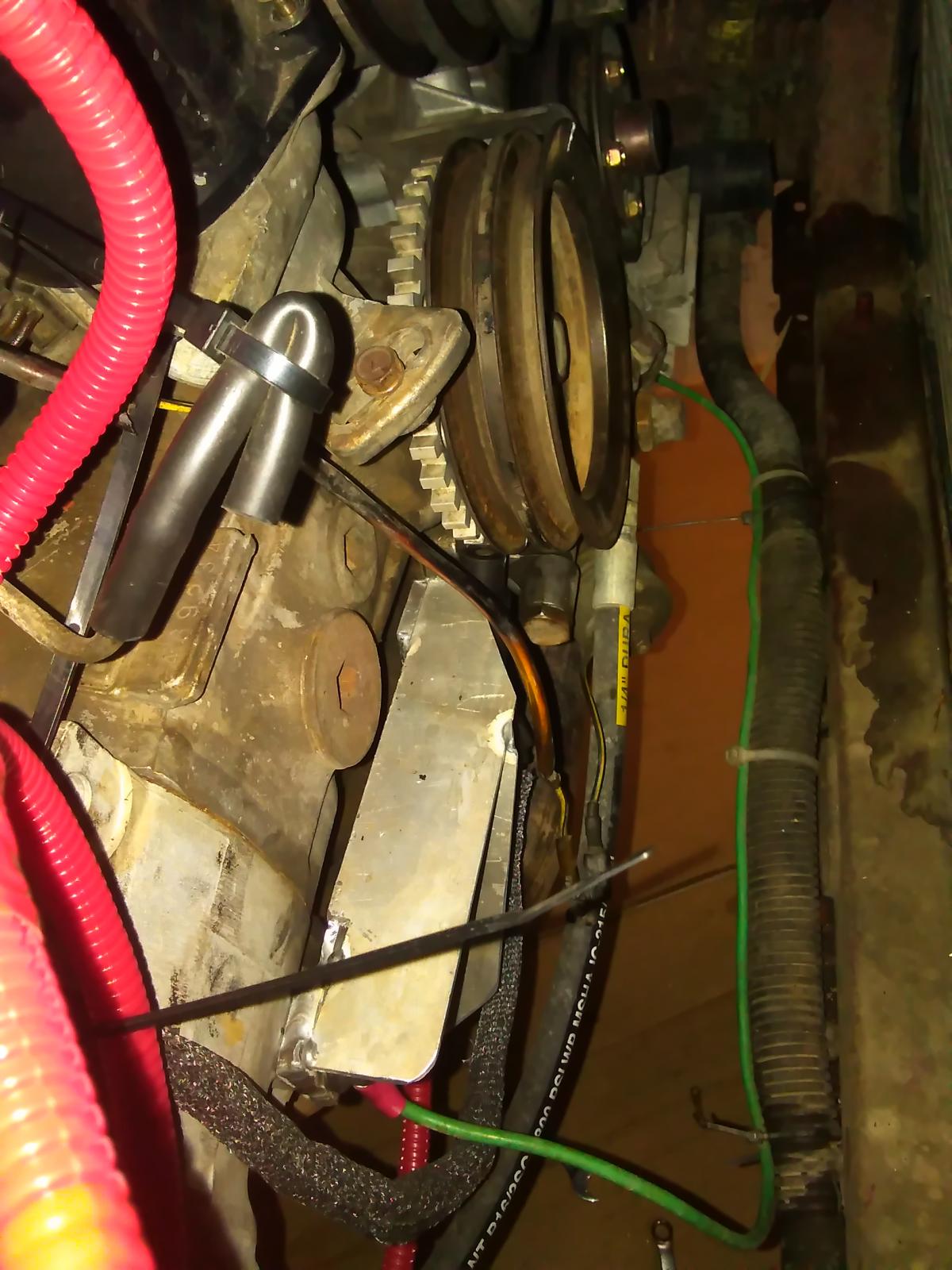

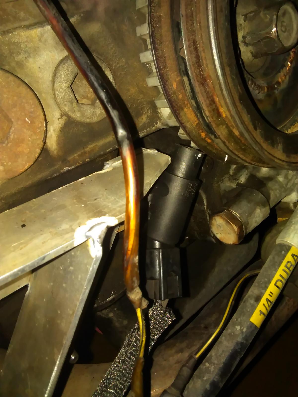

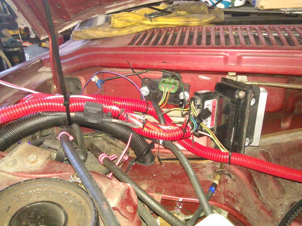

Photo dump. Check back for descriptions. Ford Edis control module I used a fuse as a means for a jumper. The module can run independent from the micro squirt when the jumper is removed. Mega squirt has info on their site of where to get parts at pick and pull or new. Crank wheel came from 98 Ford ranger. easy machining on the lathe the make it fit the Subaru crank pulley. Of i has to do it again, I might buy the wheel from DIY auto tune. Mounting the sensor is tricky. The only bolts near the crank pulley are the oil pump, and those need to seal. So I bolted to the large bolt on the head and on oil pan. Mixed and matched to save money. I got some parts from DIY auto tune,. Rock auto and pick and pull. I'm in for about $600

I know a few folks have dabbled with this but it does not seem to be well documented. I'll build this into a write up Once i get up and running. I Got my Microsquirt wired in. I'm starting with ignition only. Ford EDIS with VR sensor on Crank. I used power from the coil to close a new relay for the EDIS and Megasquirt. (black-white) I spliced together the Yellow Tack wire (subaru) to the Green Tack output from Microsquirt. The yellow wire used to come from dizzy and and go to the ECU and Tack. Fuel pump does come on. My tach bounces while cranking but I am NOT getting the injectors to open. Tuner Studio also sees the crank spinning. Battery is charged to 14v. While cranking the timing light shows 7* advance. (not perfect but close) Any ideas on why I'm not getting fuel? There is an extra grey wire that used to be connected to my coil. It is not in my wire diagram. Does it need to be grounded? Thanks!!!! Photos coming soon!

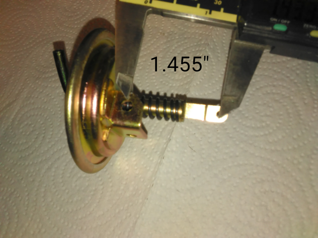

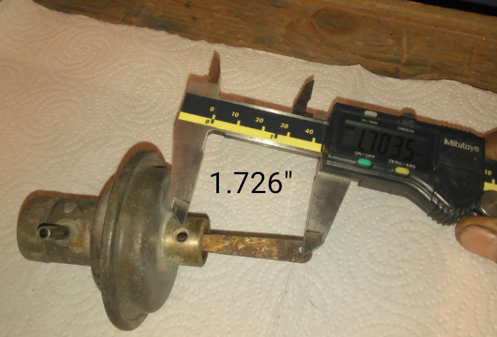

So I'm trying to fix the Vac advance on my EA81 Turbo (from the factory, not retrofit.) I got a 82 honda civic advance diaphram from Autozone. Part number JV1421 from Duralast. I don't like house brands like duralast but Autozone could get it the quickest and it will be easy to return. The honda vacuum unit is very different from the Subaru unit. Biggest issue is it is 0.25 inches shorter. My measurement is from center of the mounting hole to center of the mounting hole. Stock unit: 1.726 inches Duralast JV1421: 1.455 Inches Also the Duralast unit does not have a threaded mounting hole like the Subaru unit. The Mounting hole in the distributor would have to be drilled and tapped. This part looks exactly like the unit linked Ebay and Oriley previously in the thread. This thread references a honda Vacuum Advance, but for an 82 HONDA ACCORD http://www.ultimatesubaru.org/forum/topic/47195-wanted-hitachi-vacuum-advance-units/ Standard Motor part # VC-429 According to Rock auto Parts matching is not the same accord to civic. Next step is to compare one of these. It could just be that the Turbo unit is very different than the naturally aspirated dizzy. -
