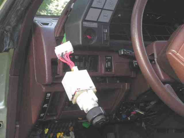

I am an elctronic engineer , but even so you need to know the ins and outs of the circuits. I have a FSM for an 88 model and also earlier ones : not for 86..... It is a bit complicated as some of the switching is done at ground level and some at +12 volt. I still doubt if it is the switch. Any way , in this country a Subaru is like an elephant in Alaska..... Parts : a dificult story , junk yards do not have them. I believe to be able to fix it , if I have the right docs.....- Strange Light-switch problem
In my (Japan made )wagon 1986 , 4wd , turbo , the light switch is combined with the parking light switch , and the inner axe has the dimmer function for the (digital) dashboard. See picture..... The high/low beam selection is with a separate up/down switch under the steer. Inside the housing of the switch are a lot of electronic components. The dimmer function no longer works , always on maximum , turning the inner knob does nothing anymore. And the "Illumination "fuse always burns out... All the lights work fine........ I did not find documentation for this switch , anyboy can help me ?- crank shaft pulley bolt
