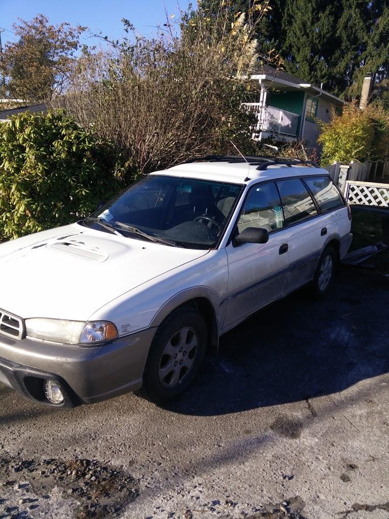

Took a while to add photos but finally got some up! Here is also one of the $300 donor Legacy I bought!

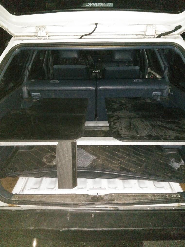

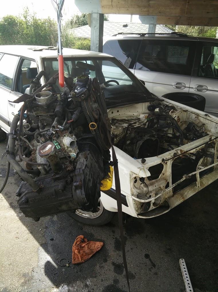

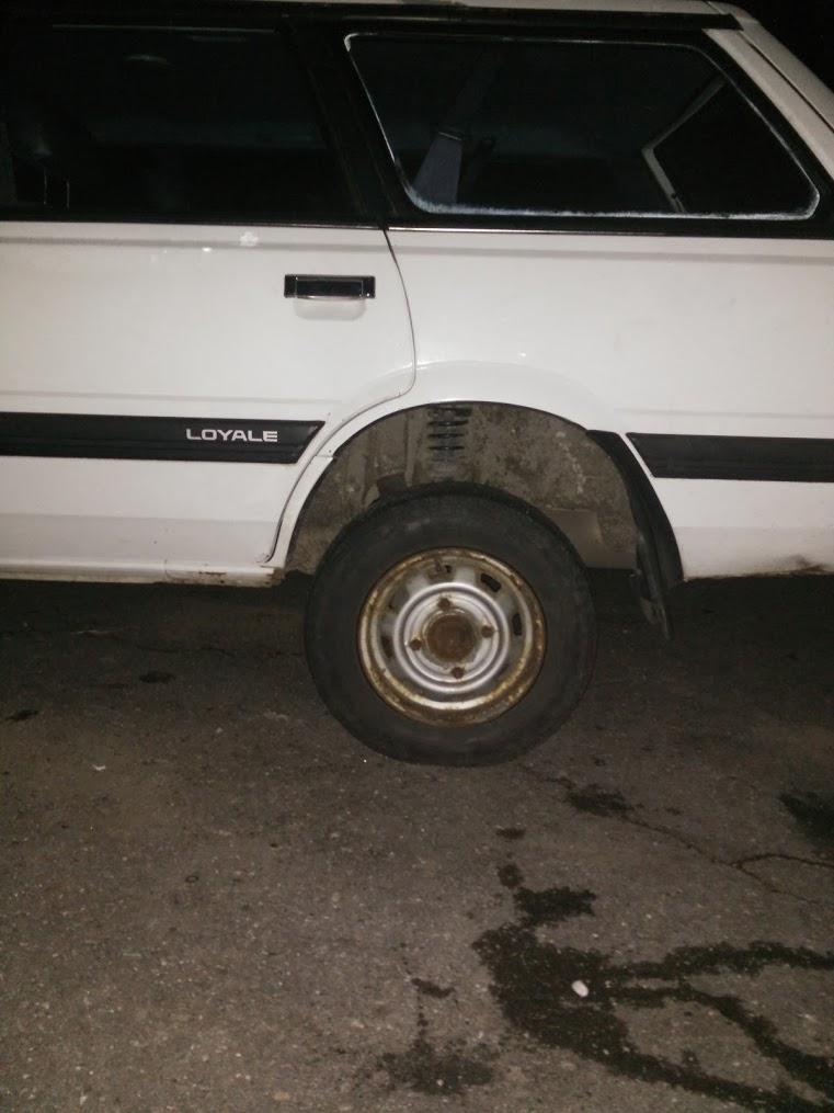

So I've been working on my car for a while and have finally started to get into some of the more fun things recently as shes been running fairly well. It started as a $400 car that came with a brand new clutch and radiator that weren't installed as the po was too lazy to deal with it. It took a while to start it when buying it but she ran decently enough to drive from Abbotsford to North Vancouver in one go. Since then I have replaced: Clutch Radiator Headlights Spark Plugs Oil Filter Plug Wires Fuel Filter Belts Exhaust Gasket Valve Cover Gasket Battery Distributor Cap and Rotor Alternator The alternator I did the Maxima swap and am running a 90amp, I've installed AUX out directly from my radio, and started to install a folding bed in the trunk with storage underneath. Currently I've also got a 1998 Legacy in the driveway that I will be swapping the motor from. Can't wait to start! Here are some pictures! Pulling the engine up into my car port to change out the clutch and radiator. Doing a dump run with it! The start of a folding bed built from foam core carbon stretcher and some aluminum scored at work. 2" lift in the rear, need to get in the front lift soon been looking silly for a minute now. A solid craigslist score of 4 15" and 5 14" Peugeot rims. Was going to sell a set but think I may just keep both in case I want a dedicated off road set in the future.

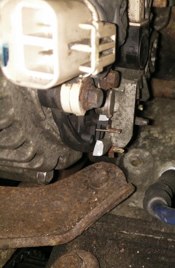

So just picked this alternator up from a 2006 Maxima, the spacing was on point, I made a bracket, then realized the guy sold me a broken alternator. It was used of craigslist, I checked my measurements and forgot to check over the rest of the part since it was so perfect. After making a bracket, shaving the spacer, installing the pulley, and putting it all in I realized the post is just plain missing. Check the photo below. Under the plastic housing is where the post should be. What I'm wondering is can I just make it work? How can I attach it otherwise? What pieces is it supposed to attach to? A picture under the plastic cover of one that's together would help... I really can't afford a new alt up here in Canada at $175 and already dropped $70 on this one that I don't see myself being able to return. For the haters, yes yes, lesson learned, spend the money blah blah. I'm broke, in Canada with expensive parts and no pick and pulls so give me some sympathy!
