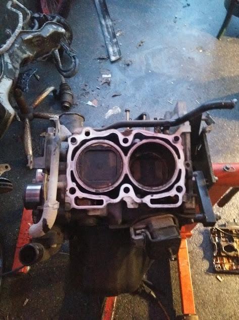

So recently I pulled apart my motor for a rebuild. Luckily haden't purchased parts yet because I wanted to see the engine condition. I noticed I have a weird style tensioner and that my year and model has come with both. Wondering why they came with different ones which is better and what it tells me about my exact engine model. This is the tensioner I have: https://i.ytimg.com/vi/aHHpFy4-sMM/maxresdefault.jpg

Managed to find some 15" pugs and tires put them on for a week and then realised that I need different lugs and took them off. Also started taking apart my ej25. Going to have lots of time in the next two weeks to research and order parts so I'm going to decide whether or not to franken motor and if I should or shouldn't get a mild delta cam grind. Probably not going to Frankenmotor. Was also thinking about a throttle body spacer.

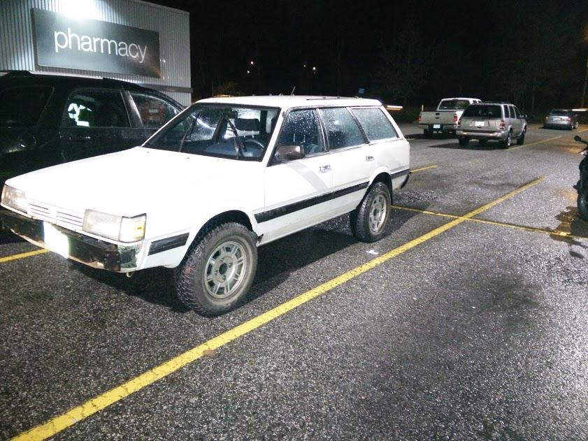

I installed everything and used the 1 1/4 cross member blocks from my outback parts car. Now my wheels have a decent amount of positive camber. Can I only use 1" blocks and get the right camber? -

So just mounted up some 215/75r15 I read they would fit on a loyale with not much trimming and a 2" lift but I'm getting rubbing at the rear of the from wheel well when turning. The outside fender itself is all gone now but its still clipping on the plastic which is backed up by some pretty integral looking metal. Don't mind trimming just wondering how much of that area I can trim away before I cut something important.

Seems as though I had just put too much tension on the system when dropping the engine and not undoing the steering coupler... Which is also likely why it was so difficult to do so. Managed to make an extension works perfect now. -

Put my 2" strut tops on last night and the steering is really heavy now. I have a 93 loyale. I put 1 1/4" engine drop from an outback on and didn't extend the steering shaft as I read the double u power steering coupler on my loyale would work. Is the steering shaft the problem or is there another issue. I also disconnected the sway bar could this be the issue?
