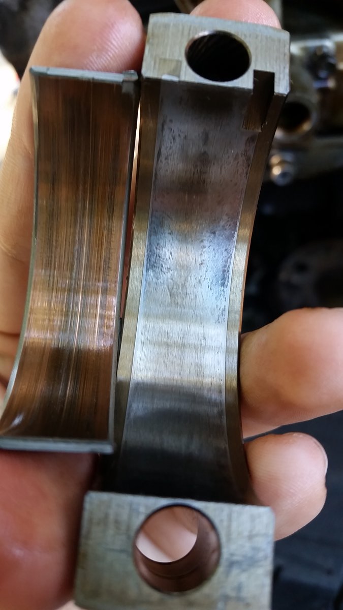

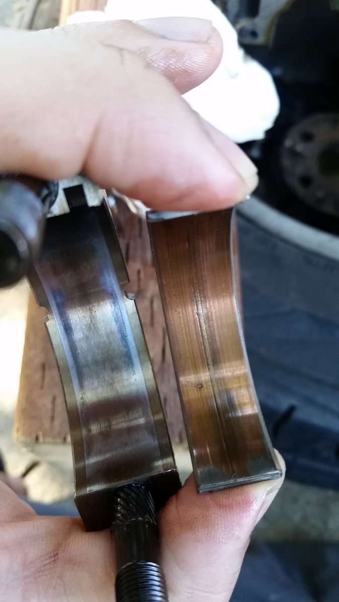

nicksubaru replied to nicksubaru's topic in 1990 to Present Legacy, Impreza, Outback, Forester, Baja, WRX&WrxSTI, SVXI personally dont like it when a post never cames to a conclusion, so... For anyone who reads this in the future. The car runs great and i followed what i was told on here except for one thing. I very lightly polished the crank surface and put in a new stock size bearing for the one rod. I used a shoe lace wrapped around and cut to size 800 grit then 1000 grit sandpaper, and wd-40 for lub. I did not go down to where all the groves were gone. And it was a complete gamble and a half. Also im running full sync oil. But as of a about 2000+ miles the car runs better then i have seen any of my cars before. So i am very happy. Not sure if i said fully all that i did. But i hot water pressure washed the inside and out of the block resealed every single thing other then spit the block halfs. Polish the combustion camber to 1000 grit. Same of the piston tops and valves. Lap the valves. Port and polish intake and exhaust to 320 grit. Full gasket, seals, and rtv ulta black where needed. Resurfaced the heads with the glass top and sandpaper to 320.Put it all back together. Thank you all for your help in making decisions. And all the great info.

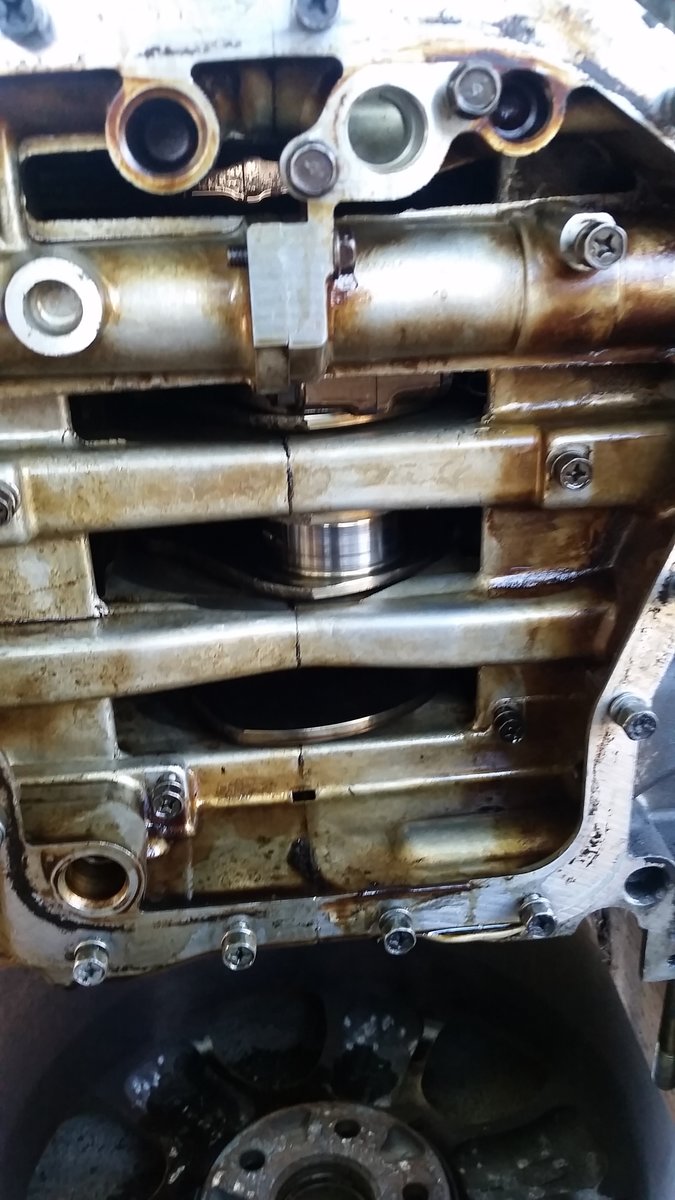

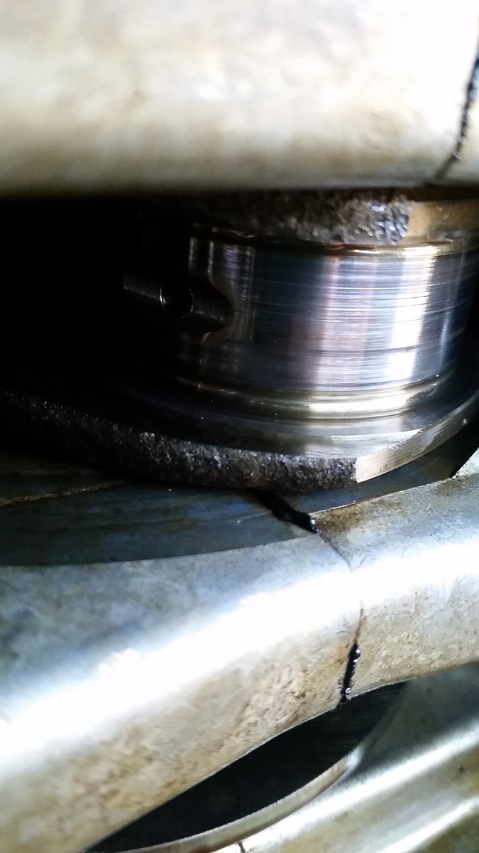

nicksubaru replied to nicksubaru's topic in 1990 to Present Legacy, Impreza, Outback, Forester, Baja, WRX&WrxSTI, SVXWhat would happen if i put in a new bearing? That's what i was thinking of doing. Figured that the new bearing would "break in" with the way the crank is. My other thoughts was that a new bearing would last longer then the old one. The old one has a little hole in it as you can see in the pic and there is small cracks in the old bearing too.

nicksubaru replied to nicksubaru's topic in 1990 to Present Legacy, Impreza, Outback, Forester, Baja, WRX&WrxSTI, SVXThe bearings say on them... F-112 979D Thats stamped on the under side of the bearings. On the rods its on that too but in a mirror image From what is seen from the pictures would i be able to get stock new bearing and put it back together? There's no way to clean/polish the crank from what i know of. Not with out rebuilding the whole short block... Unless someone in the Sacramento, CA area has a good short block for a cheap price, lol

nicksubaru replied to nicksubaru's topic in 1990 to Present Legacy, Impreza, Outback, Forester, Baja, WRX&WrxSTI, SVXIm not sure if i should be happy with this... But i was able to remove the rod without spitting the block or even taking the piston out...

nicksubaru replied to nicksubaru's topic in 1990 to Present Legacy, Impreza, Outback, Forester, Baja, WRX&WrxSTI, SVXNo sparklys or metal shaving that the naked eye can see

nicksubaru replied to nicksubaru's topic in 1990 to Present Legacy, Impreza, Outback, Forester, Baja, WRX&WrxSTI, SVXI believe this oil pump is 10mm. It should be very early bearing issue. Without removing the rod cap, there is zero show of issues to anything around it. The oil didn't have sparkles in it from what i could tell when i drained it. I may have to have a closer look at the old oil and see, i think i still have that oil somewhere around here

nicksubaru replied to nicksubaru's topic in 1990 to Present Legacy, Impreza, Outback, Forester, Baja, WRX&WrxSTI, SVXYea, i kinda gave up the idea of using that ej22 short block. Im wondering if its a good idea or not to remove the one connecting rod end from just that one that has little "play" seeing what it looks like. (the original ej25) i think i can get the cap off with out splitting the block... Maybe... And yes i know that your supposed to do all bearings and machine the crank. But its so small of a wiggle, maybe i could get away with just replacing that one bearing??? As of now, im already thinking that i could just put it back together with maybe 10w-40 or thicker oil and drive it easy. Might get another 10k miles out of it. There wasn't a knock when i pulled it. Thoughts?
