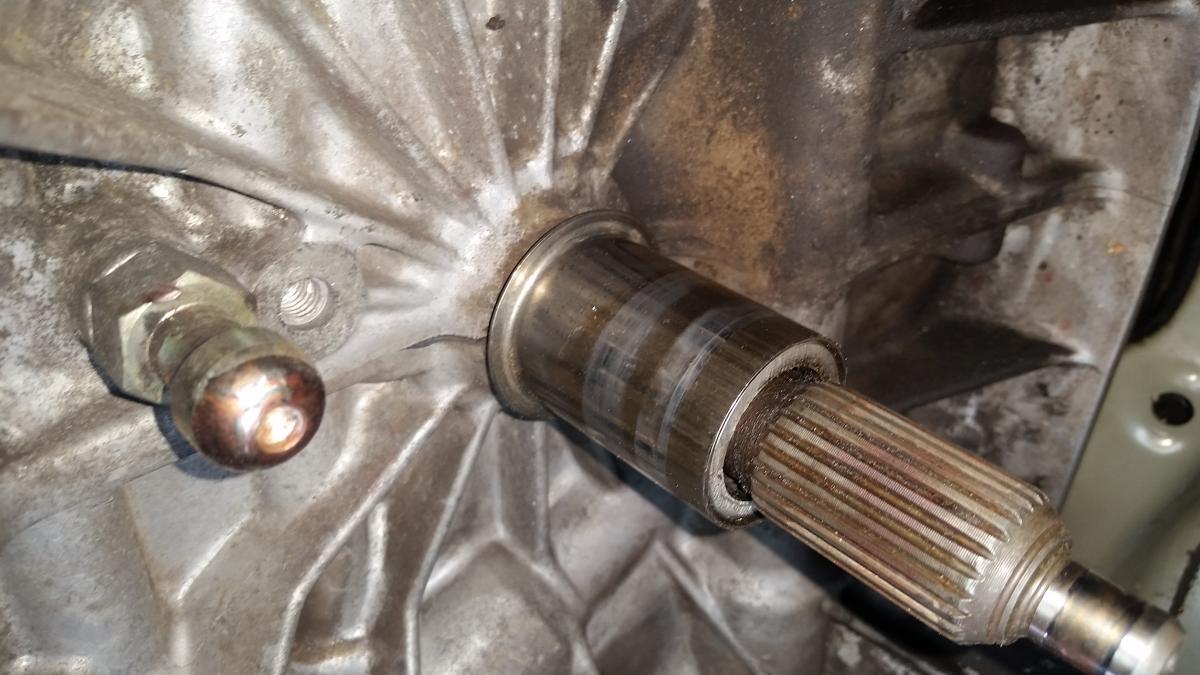

nicksubaru replied to nicksubaru's topic in 1990 to Present Legacy, Impreza, Outback, Forester, Baja, WRX&WrxSTI, SVXFrom my check, the id for that TOB part number would be 1.401999"
Exedy clutch kit issue 2000 OB ej25
nicksubaru replied to nicksubaru's topic in 1990 to Present Legacy, Impreza, Outback, Forester, Baja, WRX&WrxSTI, SVXGood idea. Ill run to the hardware store tomorrow. The id on the exedy TOB in plastic so ill have to be careful
nicksubaru replied to nicksubaru's topic in 1990 to Present Legacy, Impreza, Outback, Forester, Baja, WRX&WrxSTI, SVX@GeneralDisorder. You are very helpful. Ive read alot of older posts from other things of yours. Keep up the good work. So if i were to cut the id to 1.385" then ill be good to go? What would be the best, easiest, cheapest way for an at home kinda guy to do that? Or.... What about other options like a Toyota or Nissan TOB? I just really need this car back together already lol
nicksubaru replied to nicksubaru's topic in 1990 to Present Legacy, Impreza, Outback, Forester, Baja, WRX&WrxSTI, SVXNot sure what clutch kit you are talking about. The kit i got from exedy didnt have an opinion to come with a sleeve or anything
nicksubaru replied to nicksubaru's topic in 1990 to Present Legacy, Impreza, Outback, Forester, Baja, WRX&WrxSTI, SVXAlso this car is in the 300k miles range. If the shaft was nice i dont see why someone would even sleeve it
nicksubaru replied to nicksubaru's topic in 1990 to Present Legacy, Impreza, Outback, Forester, Baja, WRX&WrxSTI, SVXThanks you guys for being so helpful. Let me know about that part number. At this point i would rather not cut it. The stainless steel sleeve is an upgrade. I would rather have the oversized TOB or mill the new TOB.
nicksubaru replied to nicksubaru's topic in 1990 to Present Legacy, Impreza, Outback, Forester, Baja, WRX&WrxSTI, SVXDam... Sounds like i have to make a run to auto zone... And now ill have an extra TOB for no reason.... Theres no point in me taking it off if i have to put an other one back on...

nicksubaru replied to nicksubaru's topic in 1990 to Present Legacy, Impreza, Outback, Forester, Baja, WRX&WrxSTI, SVXYea, i looked for exedy over sized TOB as well. Ok so the next thing, how hard is it to remove this sleeve. It doesn't have set screws
nicksubaru replied to nicksubaru's topic in 1990 to Present Legacy, Impreza, Outback, Forester, Baja, WRX&WrxSTI, SVXI dont have a lathe.... I have a vise and a hand drill. Any ideas on how i can make this work?

nicksubaru replied to nicksubaru's topic in 1990 to Present Legacy, Impreza, Outback, Forester, Baja, WRX&WrxSTI, SVXSo i believe that there is a repair sleeve on this transmission... So now i have a new TOB (throw out bearing) that i cant use. And i have no idea out to pull off this sleeve. It is not like the repair sleeves ive looked up with the little screws on the sides. Its just pressed on or something. I found one repair kit with oversized TOB. But it was $160. The clutch kit was $230. Any idea if i sand down the inside of the TOB that i have to make it fit? Bad idea, or good idea? The sleeve thats on there now isnt in bad shape
The throwout bearing is too small of the inside diameter to fit on to the input shaft sleeve? Do you think i simply got the wrong part from exedy? Or am i missing something?

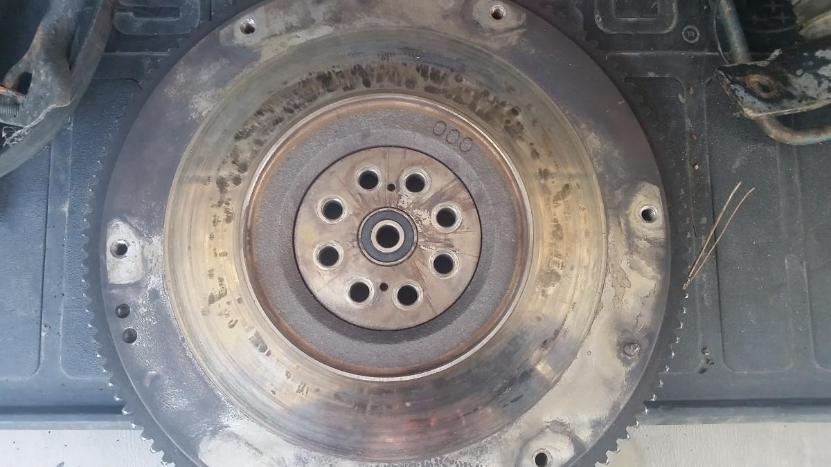

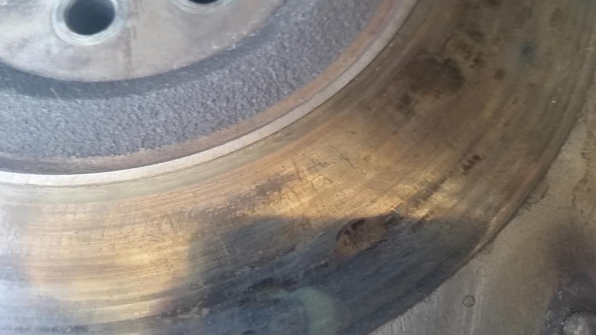

So i when to put everything that i got together, put the new clutch in, put the motor back in and all that. 1st time for me....i didnt know that i needed to resurface my flywheel. So i cleaned it up myself and before i was going to take it to resurface it, i sew hair line cracks on it. I have a 92 legacy ej22 part car. And it had a lighter flywheel, looks a little bit different then the ej25 Flywheel just slightly. And the gear ring for the starter is in better shape. So my question is should i try to resurface the hairline crack ej25 Flywheel or resurface the "no cracks" ej22 out of the 92 legacy?
