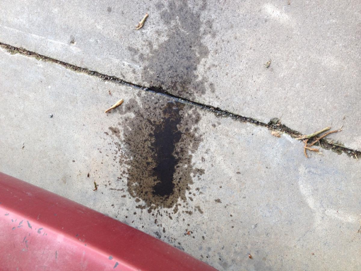

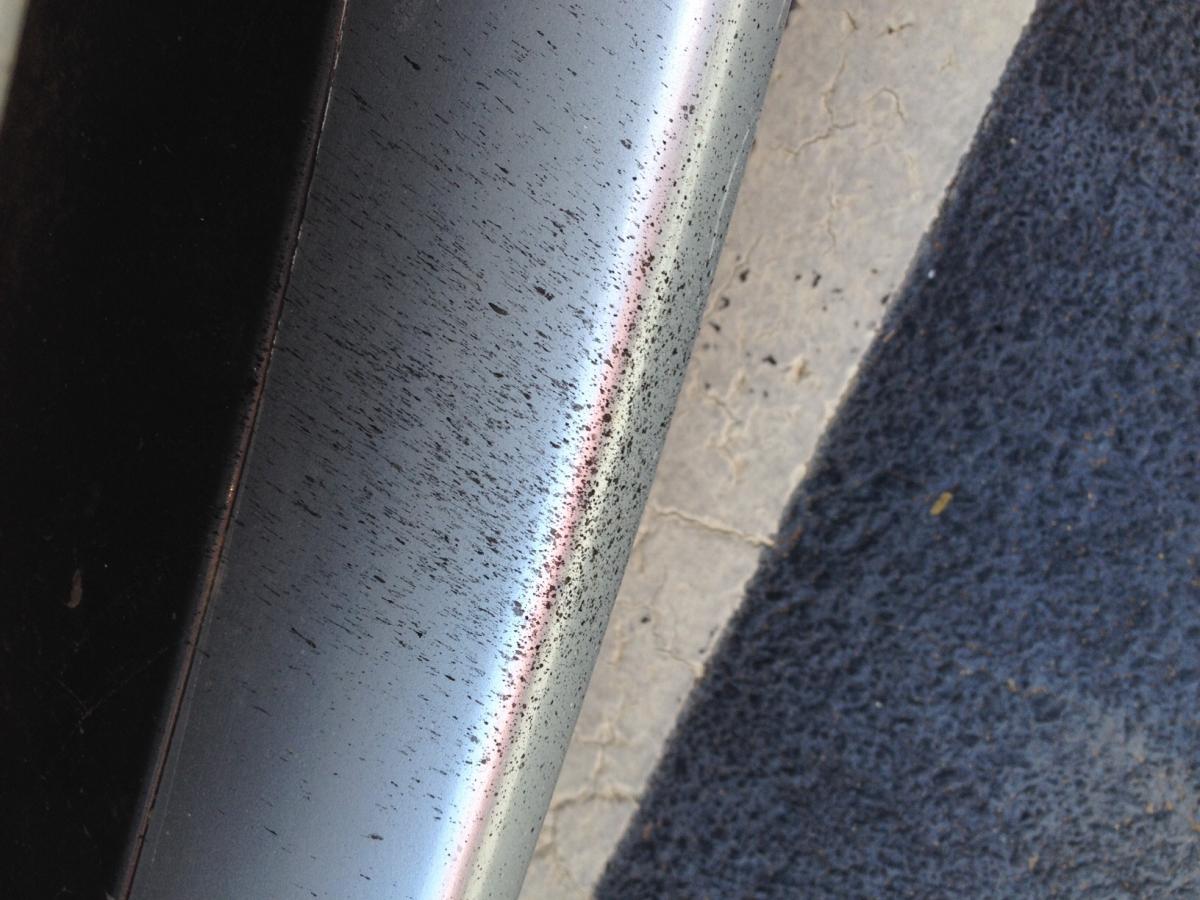

subakev replied to subakev's topic in 1990 to Present Legacy, Impreza, Outback, Forester, Baja, WRX&WrxSTI, SVXcheck this out. I tried starting my car today and it seemed ok at first, then the idle started dropping and it cut off. i tried again a few minutes later and this came out of my tailpipe

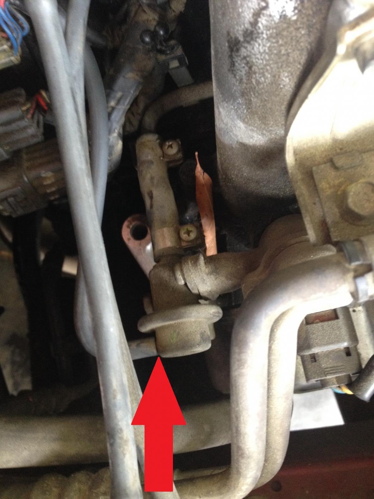

Changing spark plugs on my 95 Legacy EJ22
subakev replied to subakev's topic in 1990 to Present Legacy, Impreza, Outback, Forester, Baja, WRX&WrxSTI, SVXtiming parts seemed fine. also found some records that the timing was replaced about 30,000 miles ago. I replaced the coolant temp sensor, and found a broken vacuum line in the process. it was going into this part, is that the fuel pressure regulator?

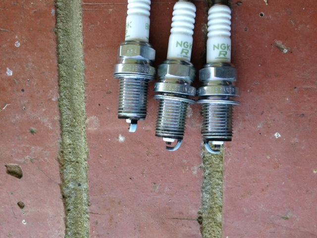

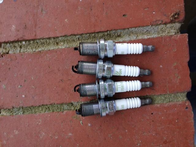

subakev replied to subakev's topic in 1990 to Present Legacy, Impreza, Outback, Forester, Baja, WRX&WrxSTI, SVXHere are some before and after pics of my plugs. the before is driving on the for about 3 hours, i pulled them this am to check them out. the after is after trying to start the car this AM, the idle was rough, liquid came out of the exhaust and it shut off before it warmed up fully and wouldnt start again. I was hoping to bring it to a mechanic I know to help me look at the timing, but probably not going anywhere today.

subakev replied to subakev's topic in 1990 to Present Legacy, Impreza, Outback, Forester, Baja, WRX&WrxSTI, SVXThis reminds me that I noticed some soot coming out of my tailpipe. There have been a lot of things popping up lately and I'm having trouble remembering all the symptoms. I've been taking a lot of pictures to help me out

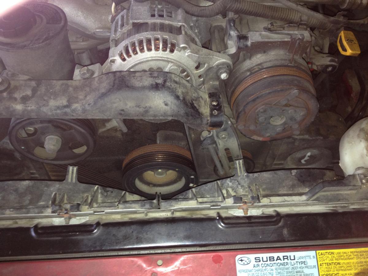

subakev replied to subakev's topic in 1990 to Present Legacy, Impreza, Outback, Forester, Baja, WRX&WrxSTI, SVXShould there be a belt on that other pulley there on the right?
subakev replied to subakev's topic in 1990 to Present Legacy, Impreza, Outback, Forester, Baja, WRX&WrxSTI, SVXThanks I will check that out. I've never done anything with the timing belt. It seems like you have to get a lot of stuff off to get at it. Do I have to take the alternator belt off and then pull the radiator out to look at it?
