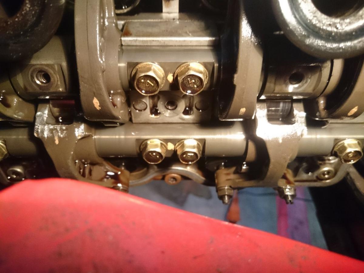

Backfiring/crackling/popping noises coming from under valve cover
Phizinza replied to Phizinza's topic in 1990 to Present Legacy, Impreza, Outback, Forester, Baja, WRX&WrxSTI, SVXFound the cause of the noise but still unsure how that damage on the rockers was caused. The two short bolts in the intake rocker shaft came out and were loose in the cam tower. There is no damage to either the rocker cover or the bolts them selves.
Phizinza replied to Phizinza's topic in 1990 to Present Legacy, Impreza, Outback, Forester, Baja, WRX&WrxSTI, SVXIt's not an exhaust gasket issue as I've felt around the gasket and there are no leaks and I'm certain the noise is not coming from that area but up around the cover. It's not can timing as I've just put the belt back on and all is set perfectly. The idle is good. Thanks for the other hints, I'll investigate when I can get back in the garage.
But if a weird one. When revving up and coming off the power I get what sounds like back firing coming from under the right side rocker cover along with rattly mechanical noises. It's an EJ25 SOHC 2001 engine. I have pulled the cam out in the past. Could it be possible the valves are sticking open allowing burning gases either way, and the tappets became out of adjustment? Just asking for some pointers on what a possible cause could be and if there is anything you suggest to look for when I start stripping it down. It doesn't always do it and pouring upper cylinder head lubricant down the throat seem to help a little. The sound isn't coming out the exhaust (only have the y pipe is on the engine at the moment) and it isn't coming out the throat either. Sound only seems to come from the rocker cover...

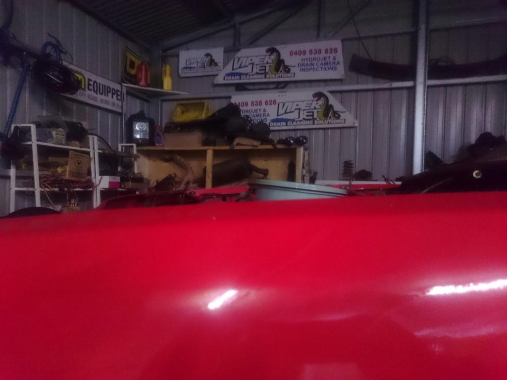

Air box clearance to hood
As I'm on my phone and I can't upload images here its probably easier to read this thread here http://offroadingsubarus.com/forum/index.php?topic=1247.0
So I put the hood on today and it clears, along with my custom strut tops, lucky!
I want to leave it off while I get the wiring and fuel sorted. Mines above the level line but I know for a fact there's a bit more room to play with under the hood I just can't remember how much as it was over a year ago when I started this project.
Hi old friends. It's been awhile since I posted on here. I'm trying to work out if my customised standard air box on a Weber will fit under the hood of my Brumby/BRAT. The hood is currently not on the car so can anyone take a photo looking across from one fender to the other across the air box? This will give me an idea of mine will actually work. I would add a photo of what I have but this site won't let me upload one off my phone.
