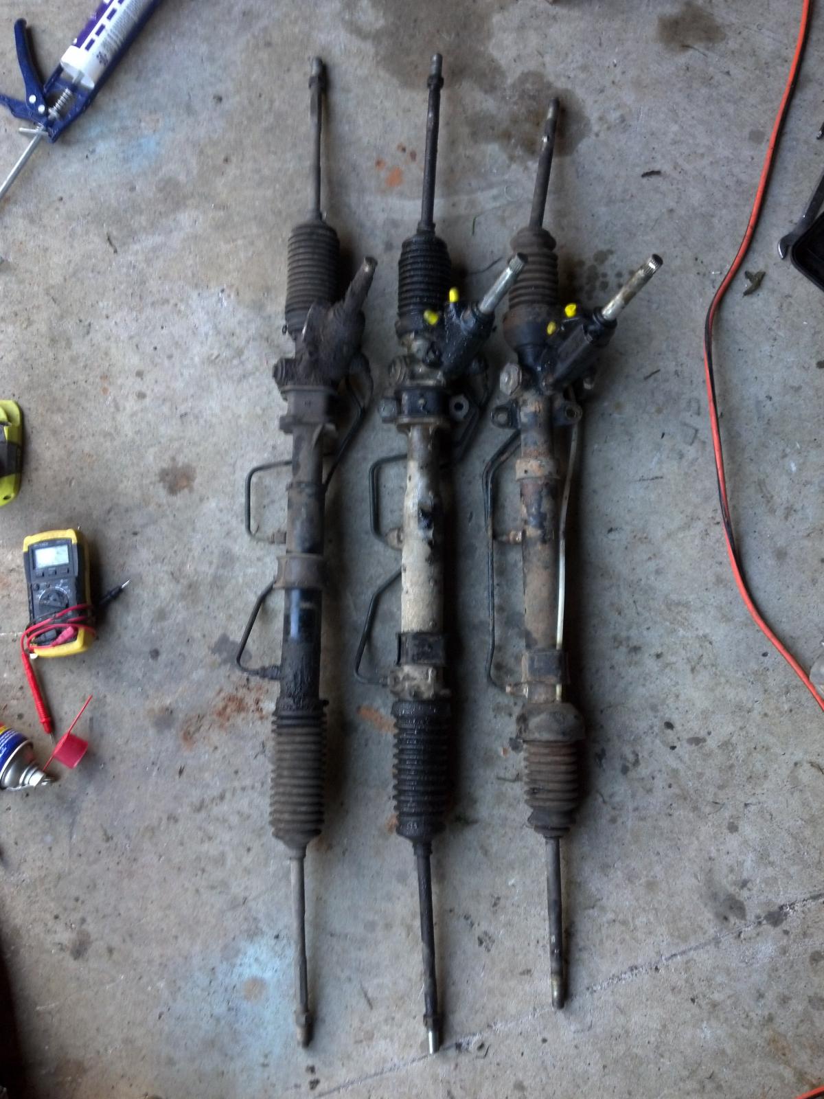

Power Steering rack from EA82 or Legacy in EA81?
Yes, found that out. EA82 rack is female m14, EA81 tie rods are female m16. I'm going to make a piece of threaded rod with both threads to adapt.
Bringing this back up from the dead as I've found all these three racks (RHD) are the same length, it's only the inner tie rod ends (rack ends) that are longer. So I see no issue with geometry running any of the other racks with the EA81 inner tie rod ends bolted to it.
