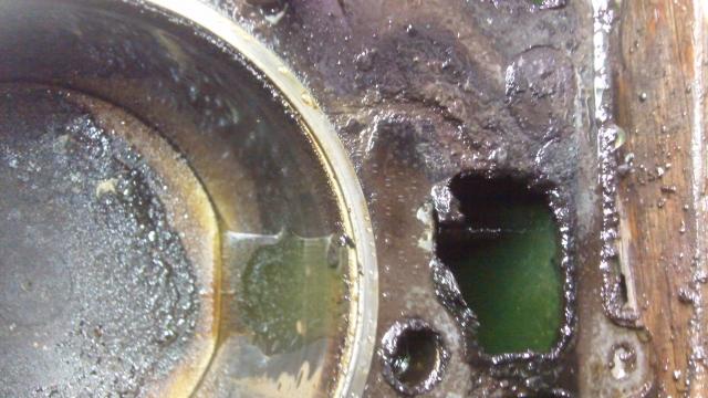

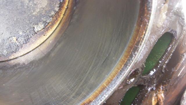

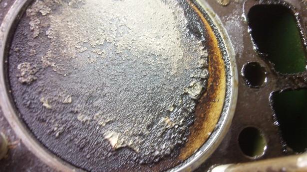

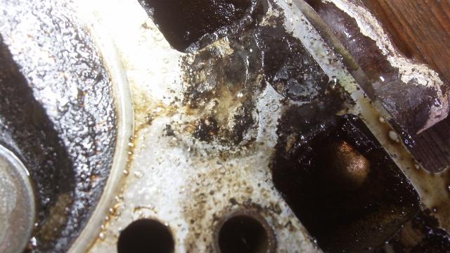

Compression 1: 90 2: 102 3: 38 4: 118 See photos of cylinder 3 headgasket, piston, cyl wall. I see a possible leakage path between the water channel and the cylinder itself. This explains the water in oil but no oil in water, correct? I need advice on how far to break down this engine now that it is on the stand. How does one evaluate? Do the compression numbers say anything about the engine in general? Should I have a valve job or just replace the head gasket and be done with it. The clutch has about 100K on it but it doesn't slip. I am still looking for a Weber DVG 32/38. I don't want to bolt that single barrel back on.

ea81 runs strong and stays cool, yet there is a massive leak of coolant into the oil pan somehow. I have to add about a liter every couple hundred miles, and my dip stick shows a couple liters above the mark. White smoke on start up. What are the possibilities besides head gasket? If it were a head gasket, how can the performance be this good? Wouldn't it dog down? Wouldn't it overheat? Starts and runs perfectly. Could it be intake manifold gasket? There is no oil at all in the radiator. The coolant is clear. I will try to pressurize the cylinders and also take compression readings tomorrow. But I can't imagine seeing bubbles in the radiator if there is no oil in the radiator now. To me it seems there is already enough information to make an educated guess. I would like to read some guesses and case studies on this.
