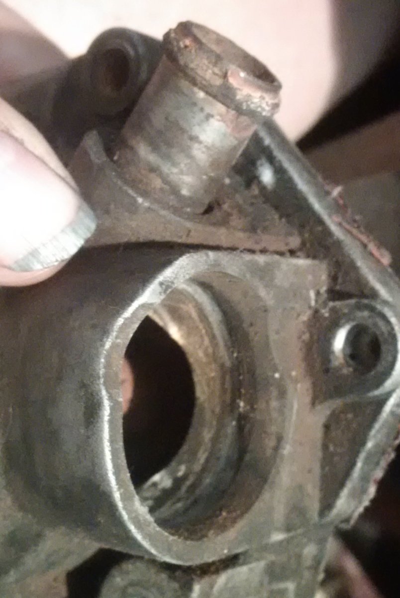

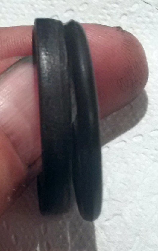

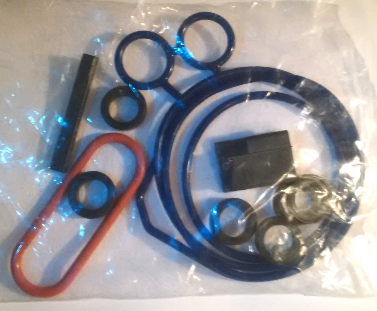

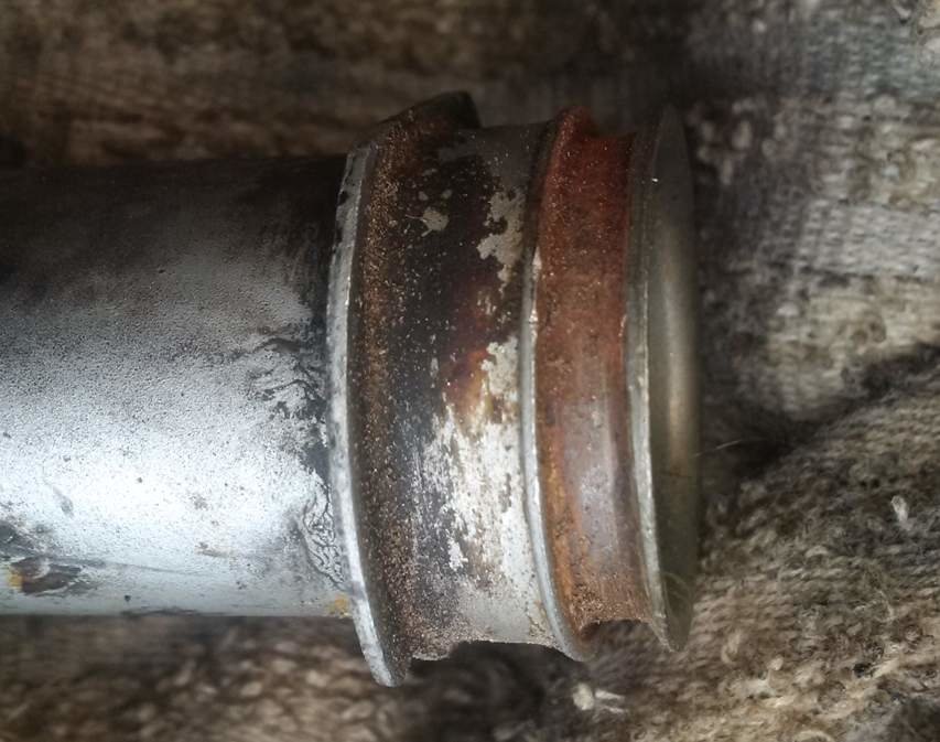

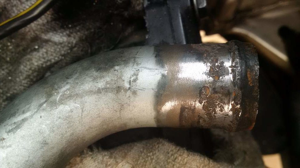

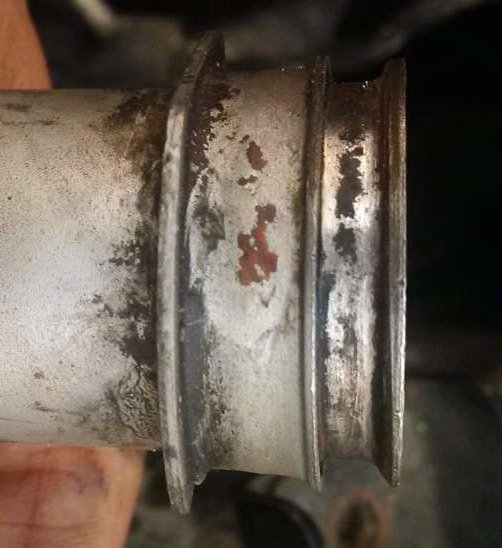

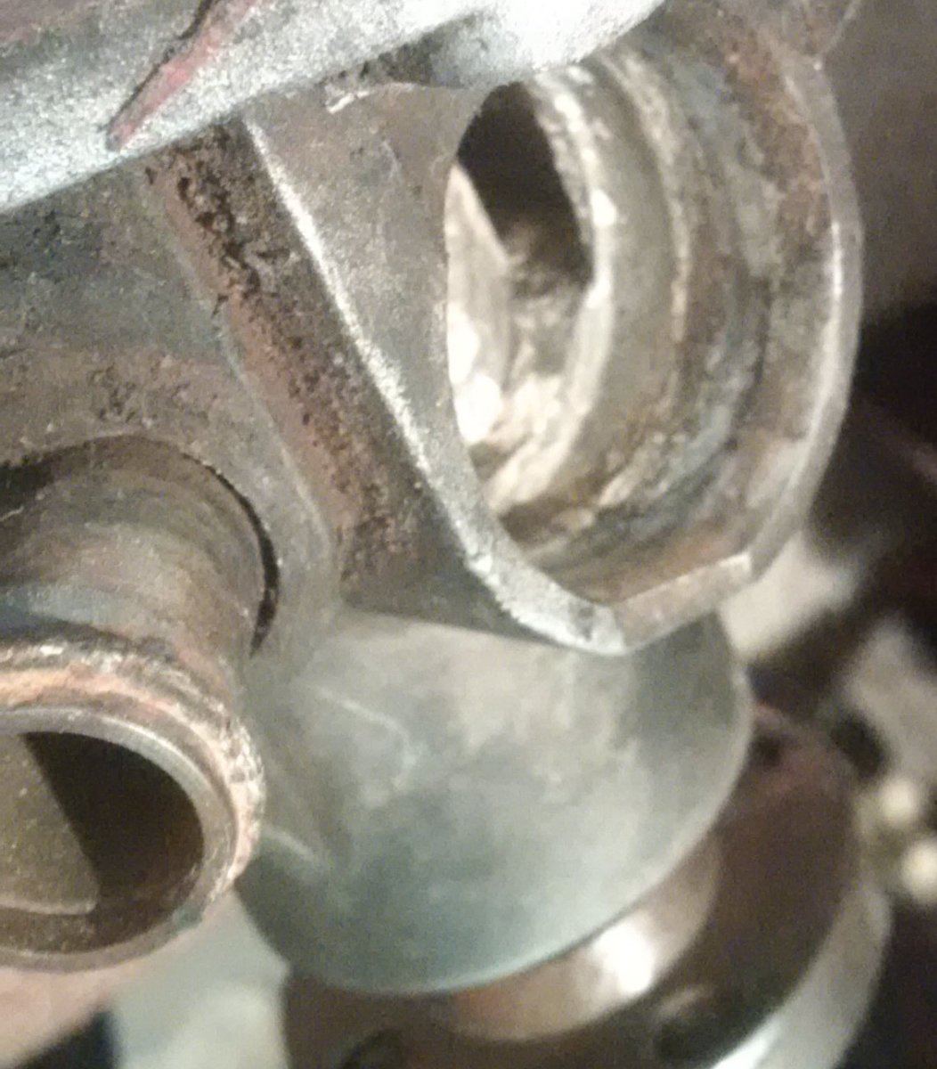

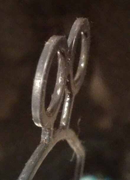

The new one I fished out of and Autozone assortment ended up feeling tighter than what probably was the stock replacement that czny sent me,which measures .115 in thickness with a micrometer . The old flat one was just slightly tight. I figured the thicker one might be safer with my old metal pipe cause it took a fair amount of filing to get it to where it was half clean metal again. I probably really ought to get a new pipe! filed.. steel wool lassoed, back & forth about 30 times here's the other end (rubber hose from bottom of radiator goes over it) - I think I REALLY ought to get a new pipe - (or maybe a new car)

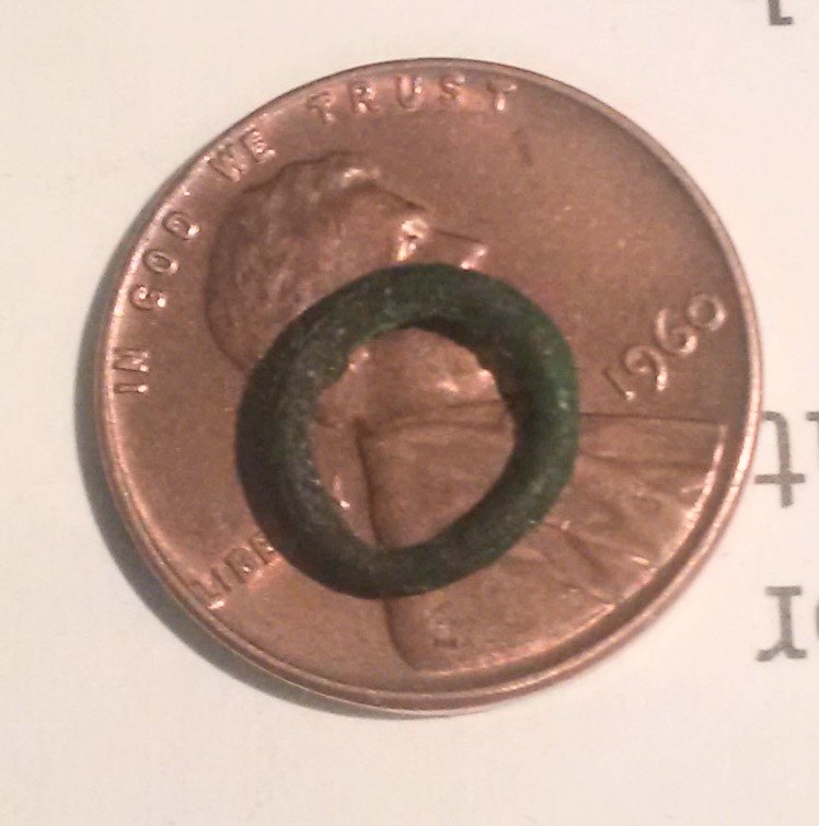

So I'm walking in & out my front door for the 10,000th time to try to move forward on my snail paced Loyale timing belt, water pump & front end re-seal job front end and I look down on my front door threshold and see this - but it may not be related at all to this project at all (I could have foraged it walking down the road & forgot) - does it look familiar to any of you Old Gen: guys? Thanks again (all I want fro Christmas is a properly rebuilt memory gland (and maybe another Loyale Wagon) )
Thanks again Dave, that makes sense and I'll give that a try also. Hindsight "is always 20/20" and you told me right from the start - "replace ALL 7 hose and this Oring.." When I woke up today I thought about how hard it is to physically measure something that has angles, distortions and curves and is rubber like - using a micrometer. So I weighed them on a digital gram scale and AT FIRST the old one weighed a little more (1.4 vs 1.3) - because I had just washed it with soap & water and dried it quickly with my T shirt... Well I figured maybe water is still deep in the "micro cracks" so I "roll snapped" it between my thumb finger a few times and then it weighed 1.3, same as my new candidate. Then I remembered I didn't throw out the old pump (it was working fine..., but replaced) and I thought I'd look into that hole WOW! That is probably why no matter what I did I could always hear bubbles in my water system when driving - REALLY AMAZING to me THAT this old motor kept "humping along" this long! Also glad overall that I had used Barr's Stop Leak (and almost 2 years earlier "Prestone AS663 Head Gasket Stop Leak with Kevlar" which had been completely flushed out a year ago ) and I seem to leave a white powder build up wherever there was a leak. Stupid joke of the day -- "Do ya think this was sucking air and leaking?"

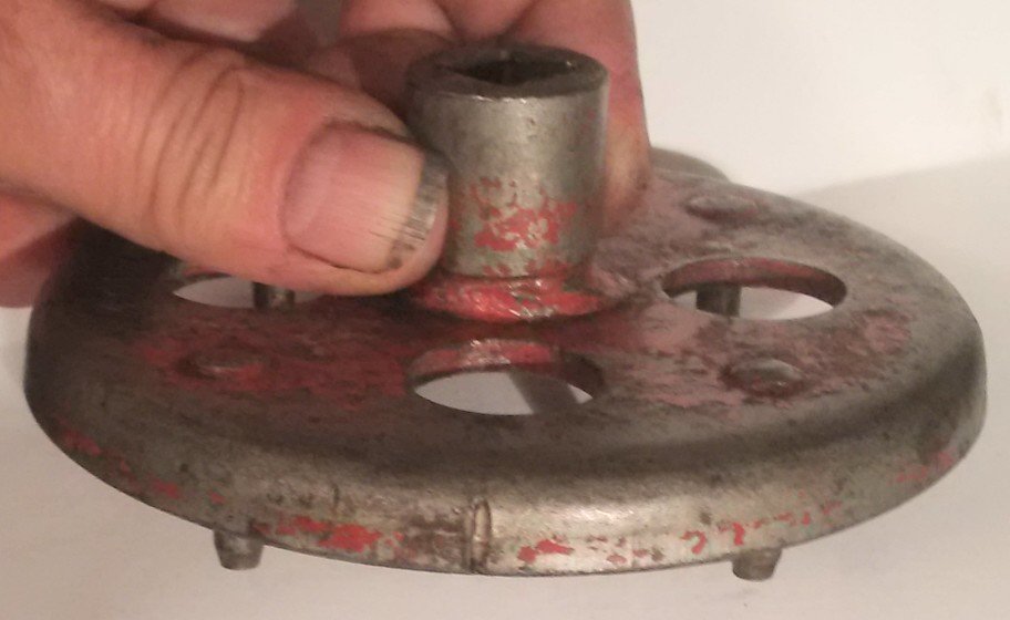

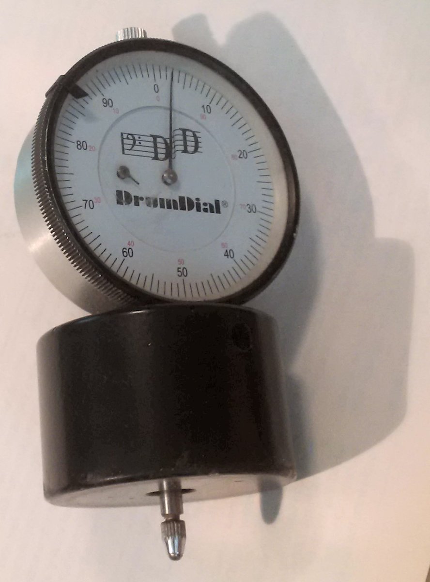

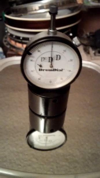

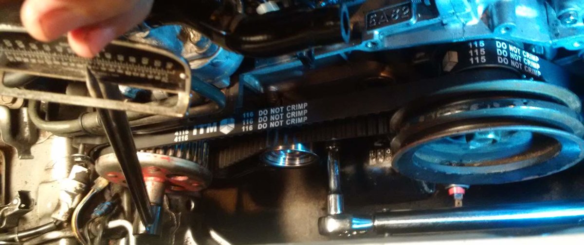

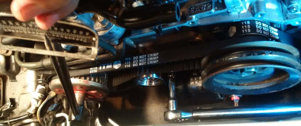

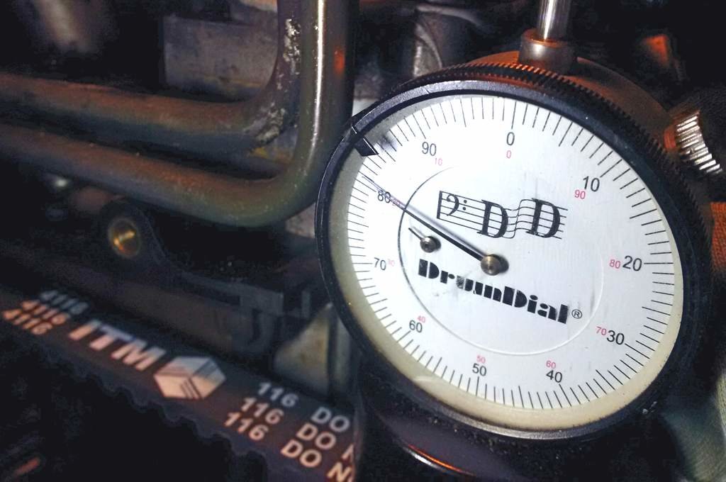

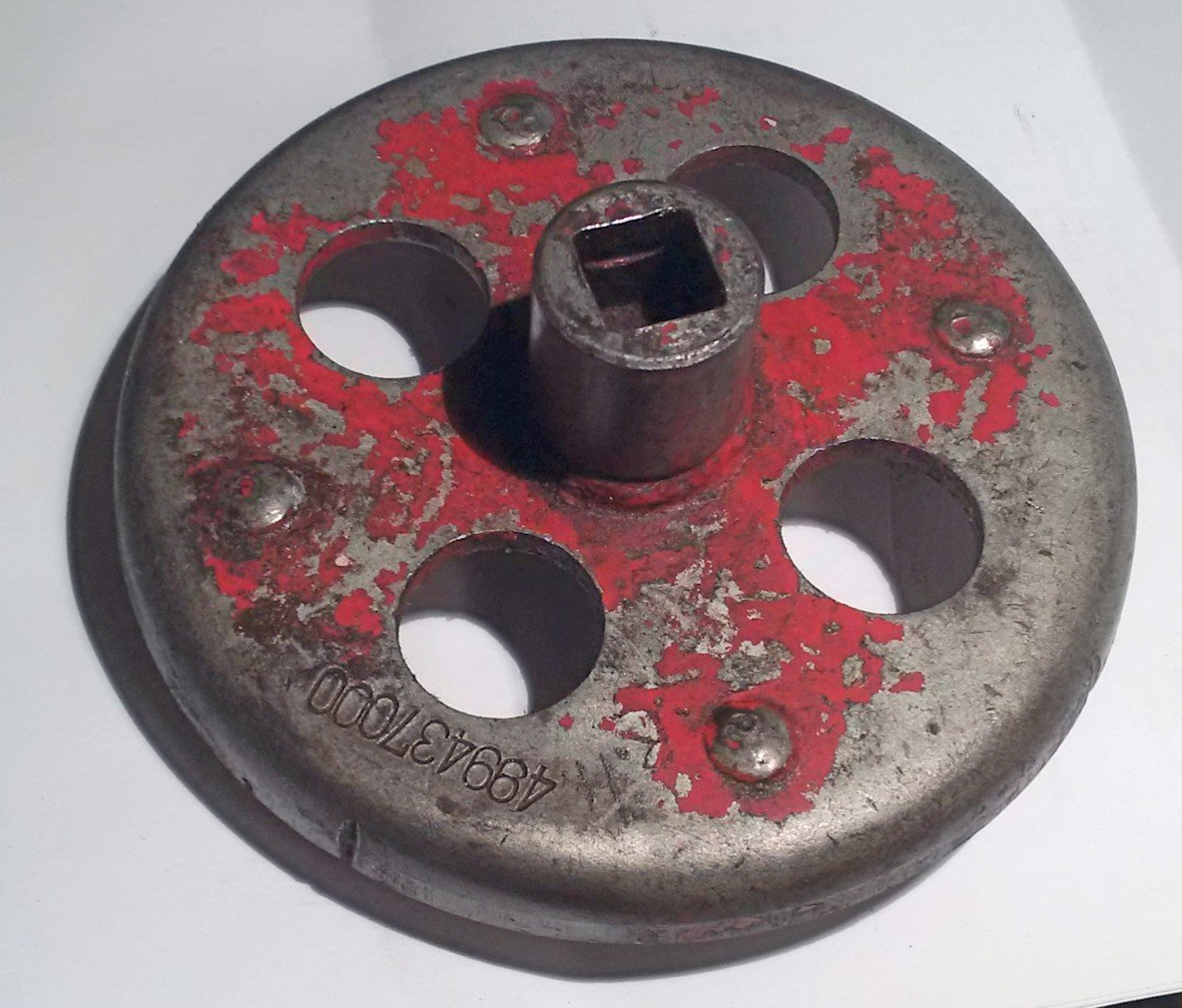

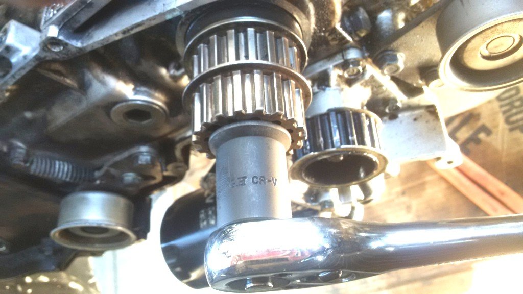

well I tested the belts "deflection" with the drum dial and it really responded to the tension on the belt that remained after the tensioner is locked down - my "guesstimate" by pushing pretty hard with my hand on the tensioner before I tightened showed 78 on the drum dial , without tensioning the belt and only letting the spring in the tensoiner apply the force , it showed 75 - measuring after following the FSM manual it was at 81(all on the passenger belt) here's the tool (red plate on the left) with the torque wrench on it - the torque wrench on the right is for the tensioner bolt. if the drum dial is sitting on a flat surface like a mirror, it should be at zero, here it is on a mirror
Ya all will never guess what THIS is ?? My local "independent Subaru Repair" guy, Chris Raffi LENT IT TO ME! What a nice guy and he keeps up a nice looking shop too, so if anyone is close to 90260 and they need pro service give him a call 310-674-5226 Raffi Motors. I'll also still see if my "DrumDial" shows differences in deflection. Now the only problem I have is I only have 3/8" torque wrenches - why they used a 1/2" female for just 25 ft/lbs. max is serious overkill IMHO.
I agree with everything you guys said - including throwing away the Haynes manual - AND FOUND ANOTHER ERROR (wrong distributor firing order) , but that will be a new topic..and I actually (embarrassingly misplaced) have a printed FSM manual set I bought off fleabay about 2 years ago - I am so grateful we have the old online FSM manual for this car (nad Ej22 &EJ25) at http://jdfinley.com/file-downloads/subaru-manuals/ , I downloaded the .pdf and can flog myself with them at my leisure, even view them in my cellphone I *think* Subaru is probably trying to reproduce the spring tension of the valve springs pushing against the cam at the point of highest spring pressure (for either cylinder 1&2 passenger side, or 3&4 driver driver side at) if examining passenger side cylinders, it would happen at the instance that the intake stroke of valve of cylinder 1 is lifting, while the exhaust stroke valve of cylinder 2 is lifting - and about the same time cylinder 3 will be starting it's power stroke. So *if I thought this out right* now that I already have the belts on in the proper position cam timing wise I can rotate the crankshaft pulley bolt with a socket (clockwise to get tension on correct side of belt, opposite of the side with the tensioner) and feel this resistance (of course got to pull the spark plugs so the compression doesn't get involved.. and take cap off rotor to roughly calculate where the valves are)and I really don't want to pull them or the cap, cause I'm so lazy ) and it should even show on a "deflection" torque wrench.... I may even be able to show a "reproducible" deflection of the belt itself using a musician's tool for determining tension on a drum head/skin - or a banjo (which is my current obsession) it's called a "drumdial" it's just a dial gauge (with a heavier spring on the plunger) mounted through a hole in the center of a 2" circular base that has a flat bottom. -=- I want you guys to know this is more focused thinking that I have done since I can remember -=- so I'm gonna go and try it and maybe even shoot one of my infamous "technical vids.." if it shows on the torque wrench - then I'll hold it there & tighten the tensioner bolts. I'm sure Abraham Lincoln got much more profit and satisfaction out of splitting logs, than I will ever get out of ending up looking like I'm working on "splitting hairs"..

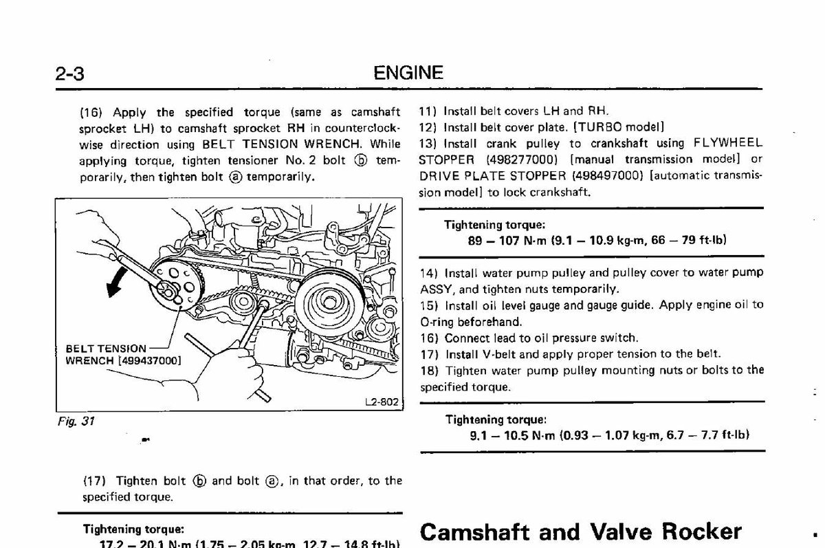

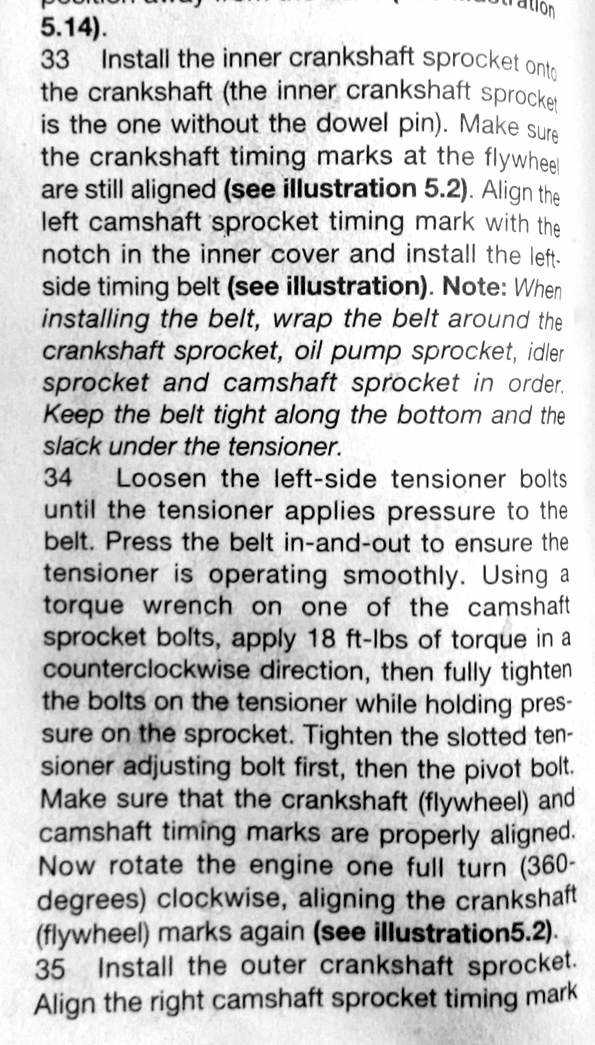

These camshaft sprocket bolts only get 7ft-lbs torque! how can you "un-torque or torque it counterclockwise " to 18 ft-lbs? it will unscrew! It's in section 34 from page 2B-6 - Haynes manual 89003 Subaru FSM says use a "belt tension wrench" that spans the sprocket (I assume?) & torque on it to 18 ft-lbs counter clockwise, then tighten tensioner.. so how do you guys get the tension right? Thanks again

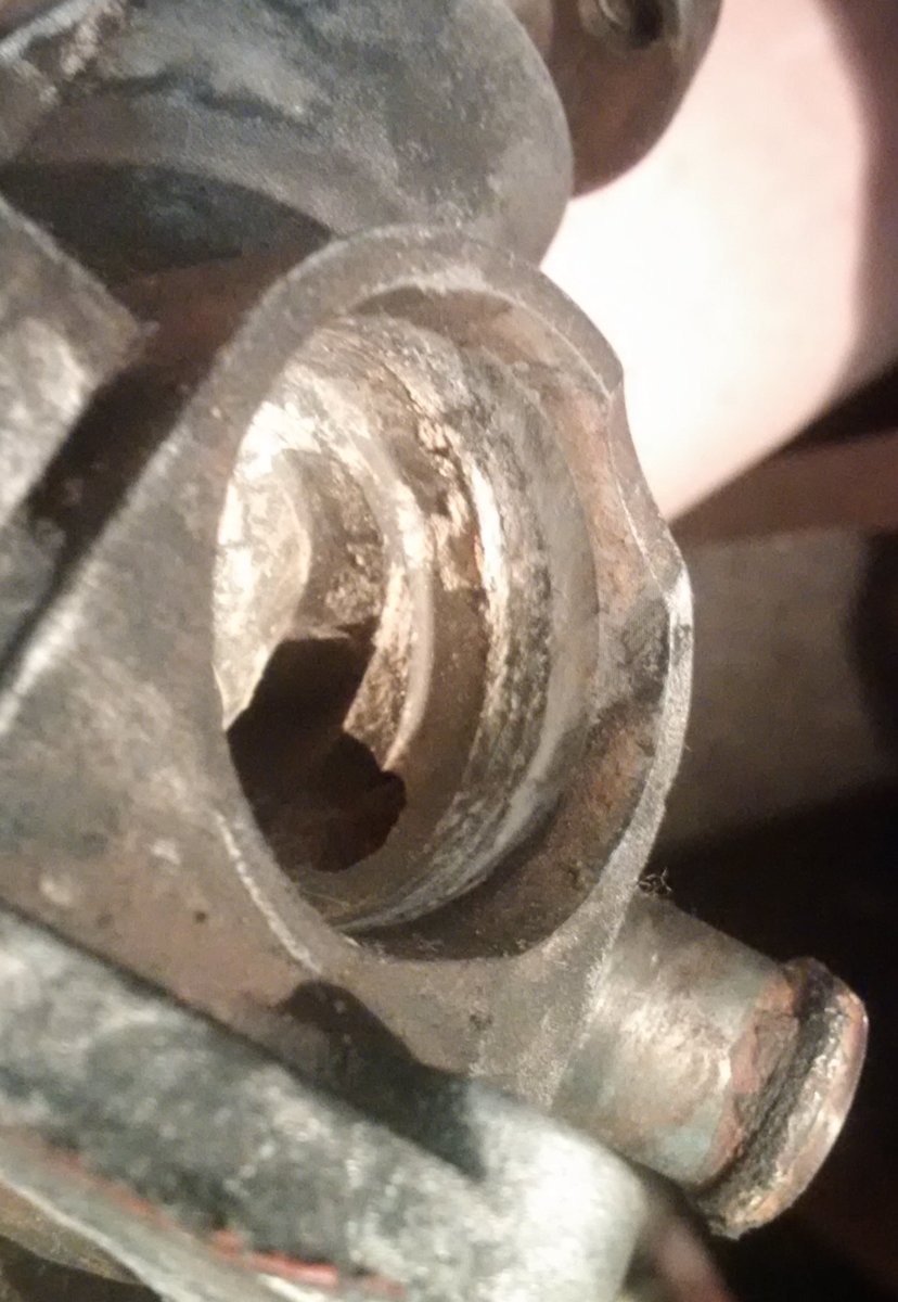

cam seal retainer bolt hole stripped
Craigar replied to dltrial's topic in Old Gen.: 80's GL/DL/XT/Loyales...

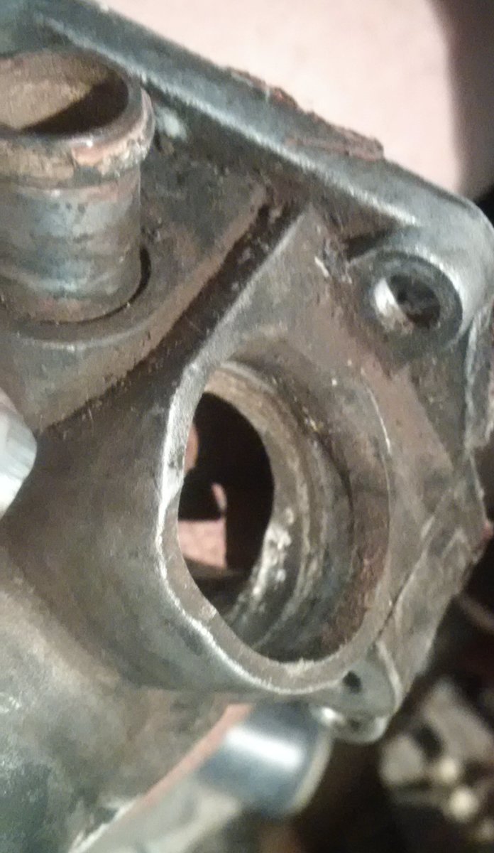

No, this was MY FAULT, I saw "Cam Housing.." which is probably what we call "cam tower" and I half a** let my brain jump to the fabled land of conclusions thinking "of course it's the "housing" that supports the cam on the end where the sprocket is .. if only I had looked at the next line - which starts with "cam.." - and the next 3 lines also... then I would have seen "cam seal retainer" for sure. Being 62 years old & feeling kinda spacey & tired at least half the time don't help either. For Christmas I'd really like a brand new brain! (at least a good rebuild -
Thanks Everybody! Thank You GeneralDisorder for the "low down" - it does NOT appear to be stated in the online Subaru manual ( or the 1990 FSM that BEECHBM69 looked through) so I'll say this "Haynes Manual (890003 (681) " is flat out INCORRECT about this (IMHO) . I would say 95% of all DIY's that follow that Haynes manual torque spec here will strip those holes! Love their line "Every manual is based on a complete teardown and rebuild.."Here's the cover of the manual. Thanks again, maybe I didn't go too far already (those holes would be really fun to repair with the motor still in the car)

Good advice about longer bolt - I also ground off the tapered tip of a tap and went down into the bottom of the hole cause the correct length of longer bolt wouldn't go all the way (without forcing it) - and it cut the threads deeper in the bottom of the hole (I think..) here's the first time I backed it out, got a littl more on 2nd pass and bolt went in smooth & torqued properly -
It's brand new ( 3/8" although from HF) and I have a pretty good sense of when a smaller bolt going into aluminum is too tight. Did a 7lb. bolt with it and it felt right (a pair of 10mm M6 holding on the cam seals). Have you torqued down the oil pump on an EA82 to this amount of torque? I think this Haynes manual has a bad typo (or braino) and tried to verify this torque setting in the online manual mentioned above - IT'S NOT In there? very weird! Do you have a manual beside a Haynes that has this info? I even dug through the vids on youtube (including milesfox) nothing definitive - or even anybody putting the pump back into the block Thanks.
that's what this "Haynes Manual 890003 (681) pg 2B-2 ©1998" says and I'm probably up to 10~11 and it feels tooo tight - should I go all the way? These are 10mm bolts with M6 thread going into the aluminum block? Here's the page out of a Haynes manual I'm going from also VERY LEARY that I couldn't find the torque specs for these bolts in either part 1 or 2 of the online 1986 Subaru Subaru EA-82 Service Manuals at http://jdfinley.com/file-downloads/subaru-manuals/ all the engine specs are in 1st manual "Engine section 2-3" page 11-16 and oil pump details are in section 2-4 page 8 has torque specs and the ONLY THING that gets 13-15 foot pounds is the nut the holds on the sprocket - and I think it's a 12 or 13mm nut going onto a steel shaft - no reference to the oil pump housing bolts (except verbal saying assembly is reverse of dis-assembly)? I've also really searched through the topics & posts in this forum. Thanks!

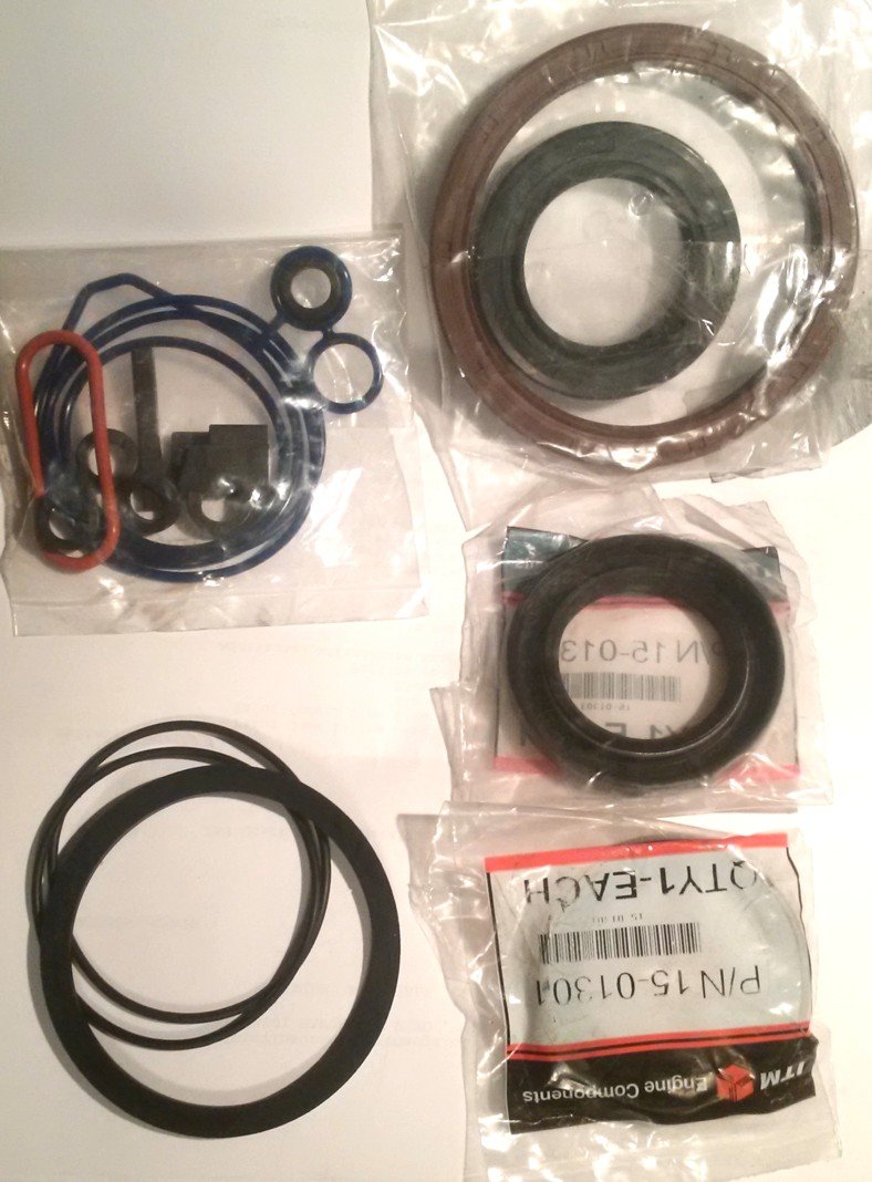

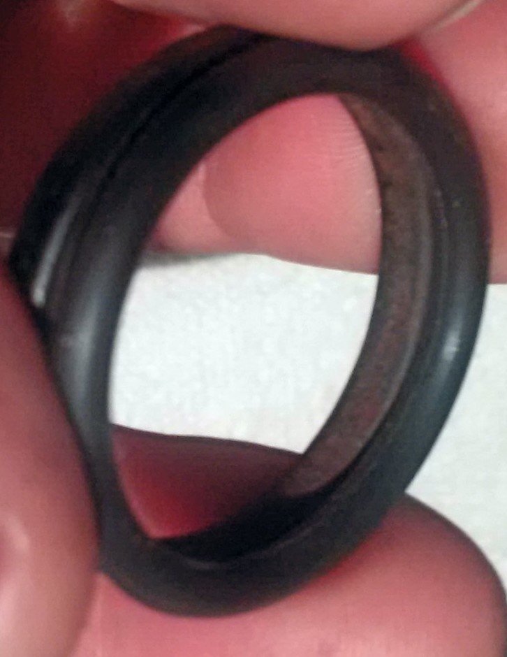

Didn't get one marked NOK - but got one that looks like NOS from czny , otherwise the seal looks identical to the stock one - and everything looks right including the little angled "oil deflection ridges" going towards the lip, which I assume "pushes" oil back towards the motor? (I - was NOT impressed with O'riely's "National" generic with no "deflection ridges" . The crankshaft seal from czny looks just like the cam seals I got out the 20 year old "last gen" box of seals a reputable full time "Subaru only" mechanic I was considering for this job (Raffi Motors ), he's the one offered to do it all for $1000, and said that's more than the cars worth.. probably true - but if I get another 100k (or more without major problems) I'll be real happy! Here's how I seated the seal.. got it level and flush with the case - used the old seal as a spacer while I very slowly turned the ratchet with my other thumbnail in the gap (at the edge) between the pair of seals and double thick reader glasses watching it move. and I KNOW it's level!

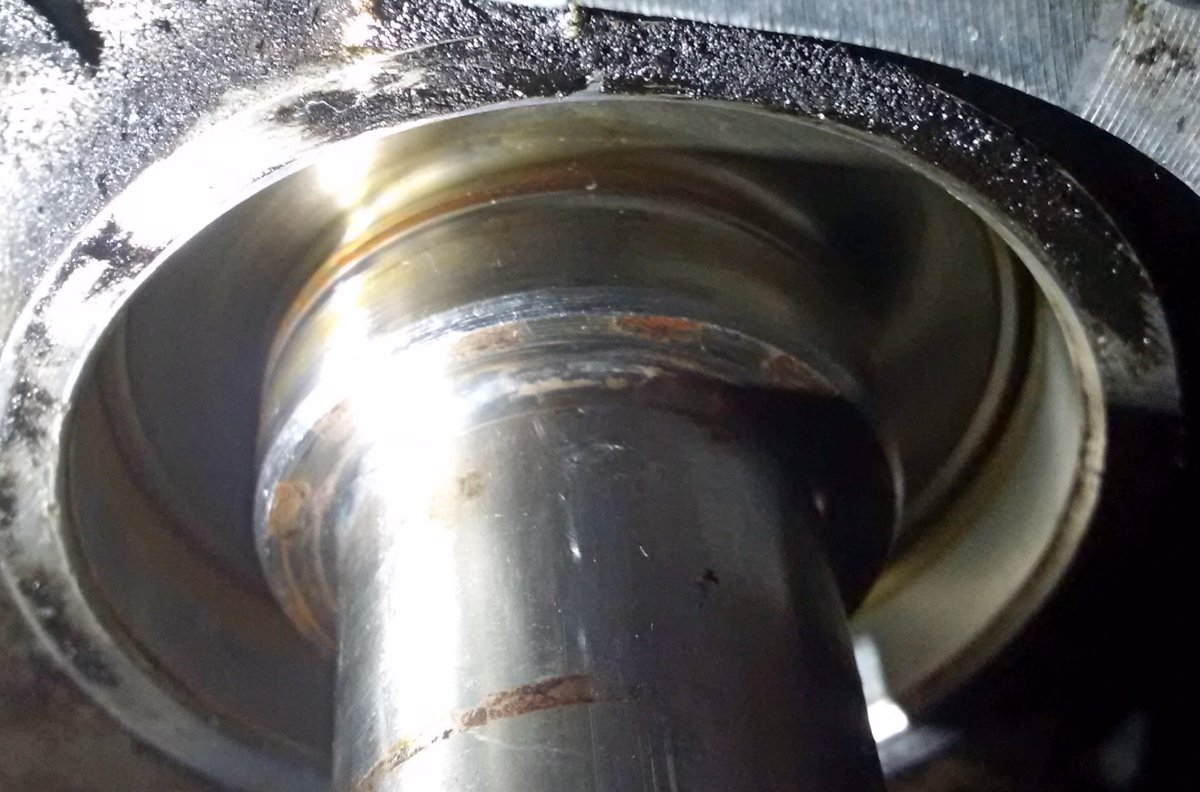

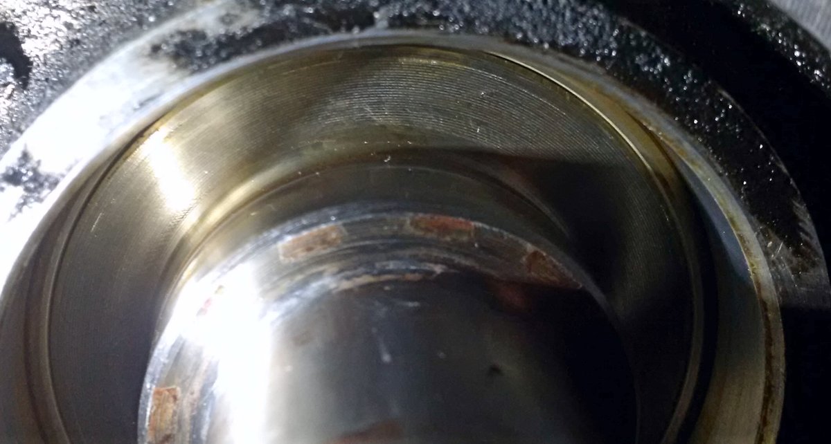

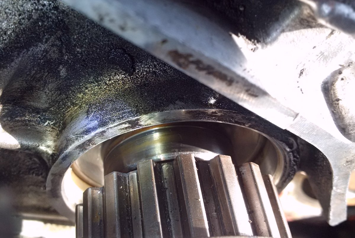

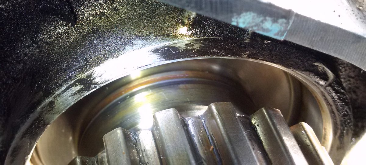

The square markings are were the backside of the sprocket butts against the crank, it's the "teeth" of the sprocket. The seal rides at least 3/16 inch further back (or more towards the top of this image). Here I slid the sprocket back on so it visually makes more sense. I think this groove is a max of .005 " at the deepest - which is towards the back (closest to top of image) right before the brownish "varnish" band. Now that I am seeing it in the day I realize it's probably not a problem . Thank You
The seal (as well as cam seals) appears to be original, (with "NOK" marking/label) and I don't know if this is a groove or maybe a stock ridge/shelf (about 1/8 inch away from radius) ? motor has 137K miles, wasn't leaking too severe and probably also leaking from cam seals and oil pump as well, resealing all of them
