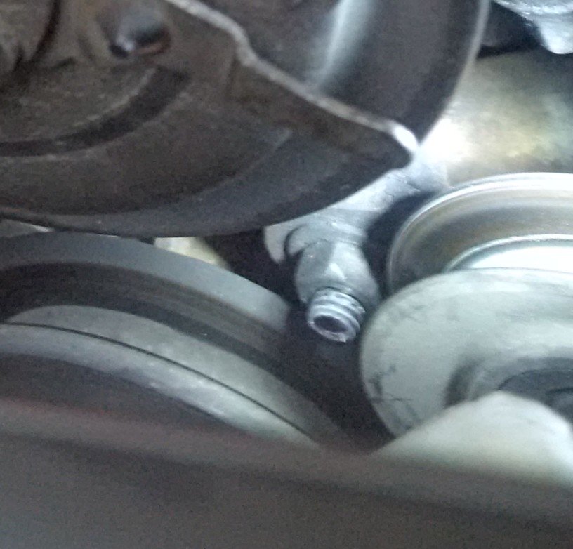

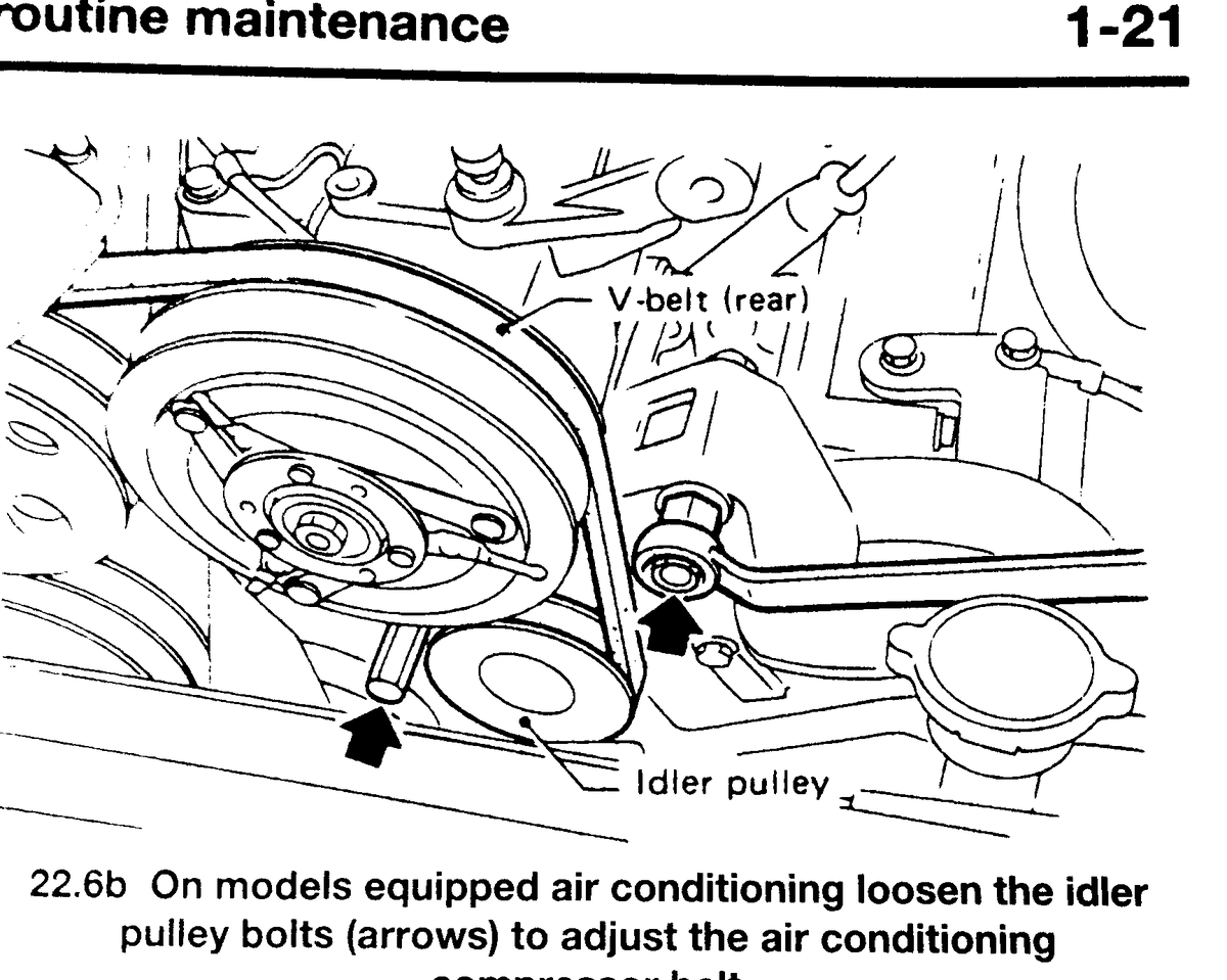

1.8 OHC EA87 "Extra" nut behind elongated adjustment nut forAC/Power Steering belt?
I don't think this nut is supposed to be here - and there are only 4-5 threads for the 1.5" long nut (so we can get a wrench on it). Maybe there was supposed to be just a lock washer - or nothing? Couldn't figure out why after loosening the pair of nuts that should let the idler pulley move (via it's mounting bracket ) it wouldn't budge?
