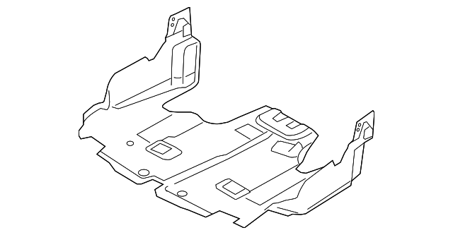

06SubLegTx replied to 06SubLegTx's topic in 1990 to Present Legacy, Impreza, Outback, Forester, Baja, WRX&WrxSTI, SVXHey, I put all new hardware along with the new guard. Where it is starting to slowly sag is the driver side where there is less plastic. I was hoping someone in aftermarket make one for the 4th gen Legacy.- 06 Legacy Engine Splash Shield
Hello, I have a 06 Legacy with a engine splash shield that is only a couple of months old and it is already starting to sag on the Driver Side where there is less plastic material. Has anyone ever found a way to brace it up or modify it so that it's not sagging like it's many years old when it is only 6 to 9 months? Thanks for and constructive input.- 2006 Legacy 2.5i (SOHC) Weird Cooling Readings on Guage

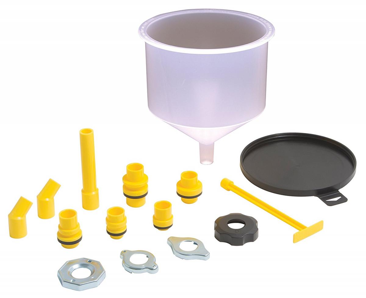

06SubLegTx replied to 06SubLegTx's topic in 1990 to Present Legacy, Impreza, Outback, Forester, Baja, WRX&WrxSTI, SVXThanks, I will try it tomorrow... Should I still attach the Lisle Spill - Free Funnel when I do this?- 2006 Legacy 2.5i (SOHC) Weird Cooling Readings on Guage
06SubLegTx replied to 06SubLegTx's topic in 1990 to Present Legacy, Impreza, Outback, Forester, Baja, WRX&WrxSTI, SVXHey, I did the Boil Test on it a few day after getting it. I will put the Nose Up again to help move the air out.- 2006 Legacy 2.5i (SOHC) Weird Cooling Readings on Guage
06SubLegTx replied to 06SubLegTx's topic in 1990 to Present Legacy, Impreza, Outback, Forester, Baja, WRX&WrxSTI, SVXHey, I never thought about the Heater Core issue. I should have because the heater core probably site higher than the engine, and I even put on New Heater Core hoses. I will try what you said in regards to increase the RPM.. Also what is: AIRLIFT?- 2006 Legacy 2.5i (SOHC) Weird Cooling Readings on Guage
Hello, So, the engine is all back together. For the initial start-up I did the Subaru Relearn after a long time without a battery. I didn't touch the accelerator pedal during initial start, and let it idle for at least 40 minutes. During this time I had Lisle 24680 Spill-Free Funnel attached to the Radiator Filler port, and the front end of the car was elevated and up on jack stand to help trapped air bubbles from the system for the first 30 minutes. So, I was letting the car idle for a long time, when I noticed the Temperature Gauge was climbing up towards HOT area on the gauge. I did not let it get there though. FYI, both fans are running the way there are supposed to. The Anti-Freeze in Subaru brand for my year of car. After I turned the car off for a few minutes the temp came back to normal (Gauge was like just below the 9 'o'clock position) Is this a air bubble that is trapped or maybe a bad thermostat? Thoughts? This is what is NEW on the Engine Cooling Side: (All Subaru Parts) Radiator Water Pump Thermostat & Thermostat Housing Both Upper & Lower Radiator Hoses- 06 Legacy Heater Core Hoses
