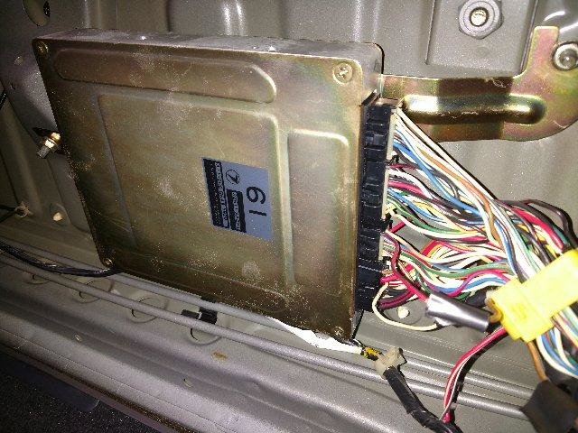

  8. Time for my weekly update... Codes, let's read codes! It's simple, plug the black connectors together. In this car, they are located in the trunk, near the ECU, along with the green, clear and yellow/amber connectors. The black connectors are U-check. Common sense here, "You Check", so I did. Plug them in and turn the ignition on, without starting the engine. Watch the green LED on the ECU and time the blinking. 1.2 sec = 10s, .2 sec = 1s, .3 sec between for each code, 1.8 sec between codes. I get two codes, 23 (MAF) and 24 (IACV), both open or short circuit. Seems easy enough, I'll have to take multimeter readings. I already did a new pigtail at the IACV, using a Hyundai Bosch type, 3 pin connector. Readings at the pigtail are perfect. I might just have to work on the fitment to the IACV terminals. As far as the MAF, I replaced the MAF with a compatible Nissan unit from Rockauto. I have a new pigtail also, but didn't swap out the original yet. Aaannd I ran out of time for the day, stay tuned.

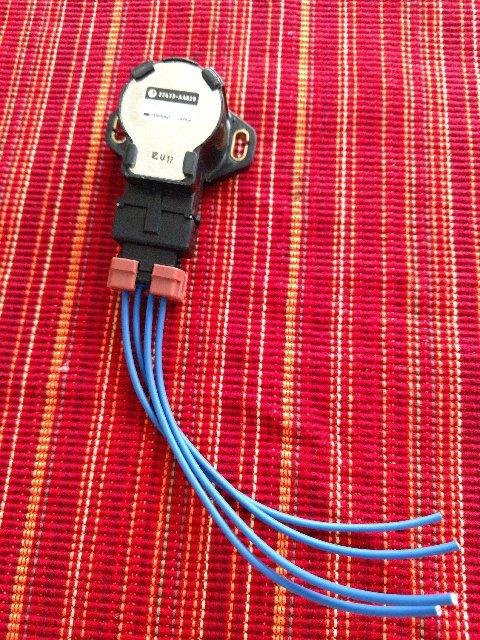

  13. Happy Easter! Over the weekend I spliced the new TPS pigtail and installed a new TPS sensor. The pigtail came out nice, readings taken afterwards are spot on, good ground, ohm readings and 5V where they should be. I made sure I put the new TPS in the exact spot as the old one was, or as close as the human eye and a picture can manage. I read a good ohm reading, only between pins 1 & 4 on the sensor, since I don't have a feeler gauge to test between pins 3 & 4 or the precise methods and extra hands needed for testing between pins 2 & 4 with throttle closed and open. Following me, I'm sure someone has done this and became aggravated. At this point, I didn't install the new ECU, being careful not to damage a new unit. This was purchased from epartsland.com for $100. This guy is located in Reading PA and from what I can tell, he carries thousands of ECUs for just about every car you can imagine. They are fully tested and have a warranty. I thought I'd just try and start the car to see what happens. Bad idea! RPMs hit the moon to 5,000 RPMs, so I shut it down immediately. I checked the repair manuals and see that I need to make adjustments using a multimeter and feeler gauges. So, I'm not gonna try this alone, I need help here and probably a second set of hands, besides my three year old son pretending to read manuals . I may ask a local mechanic to pay a house call, asking around for one that knows these old imports. Calling all Subaru Masters and Wizards for advice here please...
  14. FYI... Mitsubishi TPS pigtail part # MD614772 fits Subaru TPS Intermotor part # TH377 perfectly. I'll be installing this over the weekend. I'm waiting for an ECU and a Nissan MAF pigtail which should also fit.

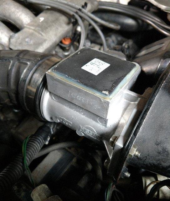

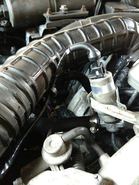

  15. Well, we are making some progress... Installed new MAF, IACV, 90 deg. inlet hose and pigtail, CTS and pigtail. Cold starts are even better than before, I notice about five steps of idle dropping to 750 RPM, perfect. Two hot starts with idle up, then down to 750, without the help of my right foot. Third hot start is still not coming down, stays around 1,750 RPM, down to 1,250 in drive. The new IACV definitely makes a difference, but it isn't the cure. What's next... I have a new TPS and pigtail coming, the original is beat up. Before I install it, I'll clean the throttle area that it connects to, it may be sticking. I'll also look into a new ECU, even though the one I have looks like new, besides the half rump roast radio splices done by a previous owner. Not an expensive NOS, if they even exist they would cost well over $500, no thanks! I've seen Grade A used ones for about $125. There are no codes coming from the ECU, no check engine light, no vacuum leaks, just one stubborn component somewhere. Another piece could be the voltage regulator, I'll look into that. Who knows, maybe the 4EAT has too much fluid in it, causing idle issues when it gets hot? If all else fails, I'll just live with it, being careful not to let it idle so high for a long time, the cars has never overheated and we know not to ever let that happen.

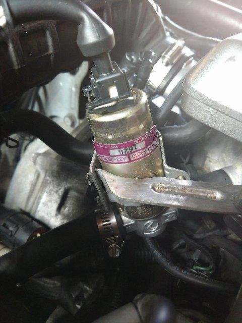

  16. I replaced the pigtail with a Hyundai IACV piece, Bosch style, 3 pin. all I had to do was file two of the tabs on the IACV and it fits nice and tight. This however, didn't fix the high idle restart issue. I think my IACV is on its way out, it seems to stick when it gets heat soaked, staying closed or open (not sure which), creating high idle restarts when the engine is hot. I'll buy a new one and take it from there. I put a new CTS and pigtail for it, the engine runs perfectly when cold started. Hopefully a new IACV solves the issue, or I may have to dig deeper into my wallet, for a new MAF and TPS.
  17. Great idea with cooling the IACV, I'll try this tomorrow. There were no codes and the check engine light doesn't come on, yet there is definitely an issue that will overheat the motor if I don't take care of it. I used a Hyundai IACV pigtail, it fit perfectly with a little filing of the connector notches on the IACV. I'm also thinking that the IACV becomes heat soaked and malfunctions when hot, but $320 for a new one.

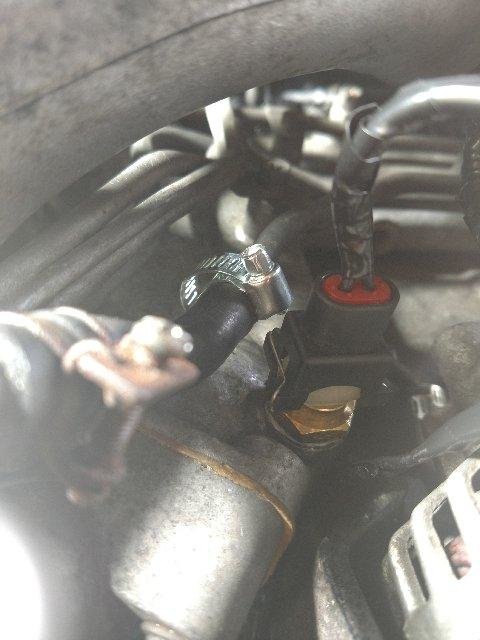

  18. I put a new CTS in today, cleaned the IACV also, its spotless and free. The old CTS was tired, the connector snapped off when I removed it, it looked corroded. Same thing though, only a smoother initial warmup from a cold start, the new CTS made a noticeable difference. Perfect cold start and two hot starts where the RPMs shot up to 1,500 RPMs and settled to 750 after I revved the throttle a couple times. However, on the third hot start, the idle ran up to 2,000 RPMs and refused to settle down to normal. The Hyundai IACV pigtail will fit with a little measuring and file work on the plastic connector housings. I ran out of time today, once I have the pigtail done, I'll give it another chance. I may have to dig into my wallet for a new IACV, maybe even a new TPS, MAF...$$$ . Maybe if I have a full day available, I'll take a look at the wiring under the carpet. The carpet is original and dry, the car has zero rust, maybe I'll find that million dollar penny under the seats! I'm not getting any check engine light and the car runs great from a cold start, something may be getting heat soaked?

  20. I have a thin soldering iron ready, but I want to try a few prewired IACV tails first. This tail is a 3 pin Bosch type, other makes use these, Hyundai uses one that looks close enough to gamble on for $15. Today I did a temporary IACV pigtail, cleaned the MAF, TPS, throttle body/linkage. The car cold started perfectly as usual, 750 RPM after warmup, even smoother after cleaning stuff, I even put a new air filter in. Two hot restarts were good, 750 RPM after the usual startup surge. On the third hot start the RPMs went up to almost 2,000 RPM, but this time I was able to get it down to 750 RPM after goosing the throttle a few times, like knocking the choke off of a carburetor. Something might be sticking, I'll take the IACV off again and use carb cleaner this time. I have a new CTS to replace the old one. After that, some further wiring cleanup might help. I have repair manuals and could read the codes on the dash, I just have to be careful with the 30 year old ECU and it's harnesses.
  21. Great info, thanks! I see a backup ECU and engine harness in my near future, just have to get the exact part number off the ECU in the car. I see some Grade A parts at Gerry's Foreign Auto Parts http://www.gerrysap.com/ I found a dealer that sells all types of connectors and terminals https://connectorexperts.com/ Their prices are high, but you can do a specific Subaru connector search. I see connectors and terminals that might work. Tomorrow I should have time to wire up the temporary pigtail for the IACV and test the CTS with the TPS and MAF unplugged. I'll test and clean the IACV, TPS and MAF also. Hopefully the hot start issue will be corrected with this simple fix.
  22. Will do, thanks. For now I picked up a Dorman generic pigtail to experiment with and continue testing. . I took the wires out and put them into the original. The terminals are a bit smaller, so I had to open them a bit, it fits nice and tight onto the IACV. I have a new pigtail on the CTS but have to check it, only getting 3.2V, not the usual 5V. I also ordered a new CTS. My issue is high idle with a hot restart, it runs fine from a cold start. Hopefully through the process of elimination I can find the gremlin. I'll clean the IACV, MAF and TPS also. I don't think it's a vacuum issue since it runs perfectly from a cold start and idles at 750 RPM all day, until I shut it down for a minute and restart it hot... zips up the 1,500 RPM and stays there, just dropping a bit when in drive.

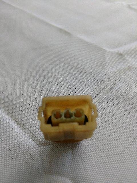

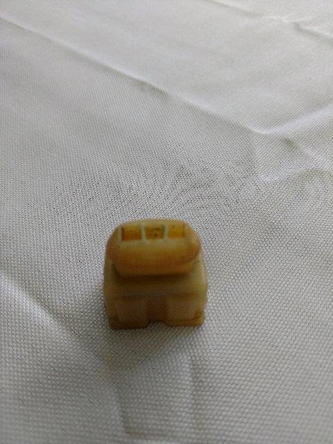

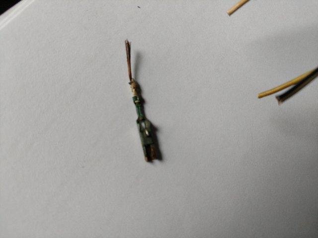

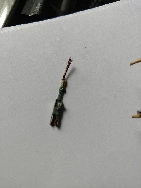

  23. I'm replacing the bent and corroded IACV pigtail terminals on my '89 XT6. I know someone here has repaired these things using aftermarket pigtails, other make/model pigtails, or knows the type of terminals I need to get the original done, it seems salvageable, check the pics and help please.
  24. I recently replaced the original CTS pigtail with an injector pigtail, but I should take a voltage reading further back. I can't do any testing until I get the IACV pigtail back in order and running. Right now the main culprit is the IACV pigtail, the connectors were bent and corroded. Do you have any idea where I can get an original replacement pigtail? Otherwise I'll just re-pin the old one. A vacuum leak is possible but wouldn't that affect the idle from a cold start? It runs fine from a cold start, hot restarts are where the high idle shows up. I picked up some carb cleaner for the IACV, maybe its getting stuck with hot starts. Rewiring the pigtail is my best bet here and trouble shooting the 3.2 V issue at the CTS and TPS would help also. I contacted a few auto electric supply places and sent them photos of the IACV pigtail, they may be able to find something that works, preferably a complete pigtail, ready to splice.
  25. A vacuum leak is possible, after I repair the IACV pigtail, clean the valve, try to get 5V instead of the 3.2V I read at the CTS pigtail and replace the CTS, I'll check for a vacuum leak. With a cold start, the motor runs fine, idling at 750 in park and drive, drivability is fine, so I'm pretty sure vacuum is okay but you never know. It's when I do a hot restart that RPMs zip up to 1,500 and don't settle down. We all know corroded wiring is the main suspect on these early ECU Subbies, yet we all throw money at everything else
