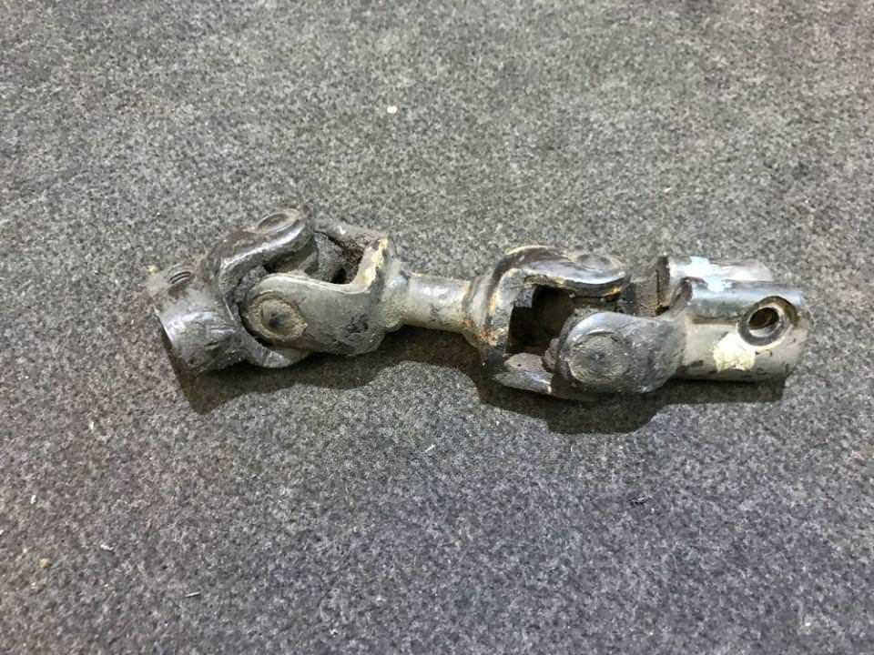

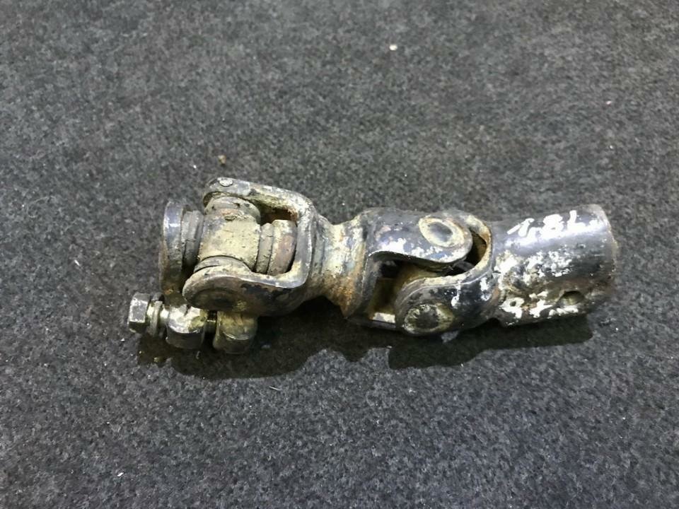

What steering coupler for EA81 / 82 PS Conversion?
Ritchie replied to Ritchie's topic in Old Gen.: 80's GL/DL/XT/Loyales...
I'll not actually manage to get to this for another week or two, but I'll post back on the results. -
I'm not home at the moment so unfortunately I can't take any measurements. The plan is to turn down the excess diameter past the threads on the EA82 tie rods and thread them further up to match the EA81 tie rod length. A quick side by side comparison looks like this is possible. When I lay the manual and power rack side by side with a GC8 WRX coupling on, it only looks to be a little longer. I was hoping I could slide the WRX coupling up the steering column to lose the excess length. I think I might have come up with another solution as well.. GC8 Impreza coupling and shorter '97 Legacy coupling, this looks like it might work. -
Hello all, I have a EA82 PS rack waiting to go into my EA81 1987 Brat. I don't have the EA82 coupling to go with it unfortunately, I have held up an EJ coupling and it looks slightly too long but could possibly be modified. Or there might be enough length on the column splines to take up the extra length. Can anybody tell me what coupling might fit, or is it only the EA82 one, which as far as I can see is very hard to get. Thanks.
